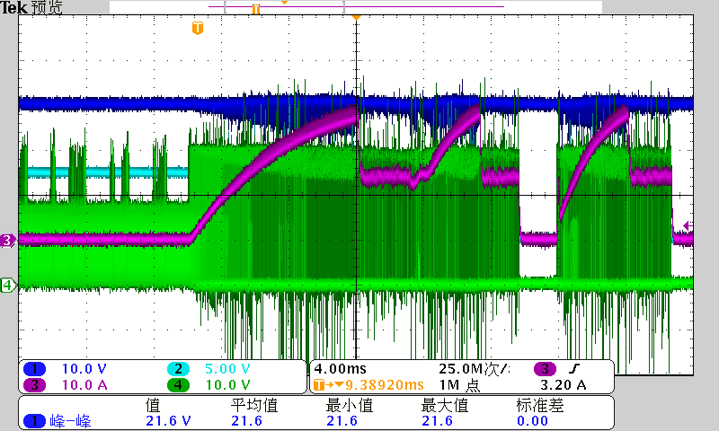

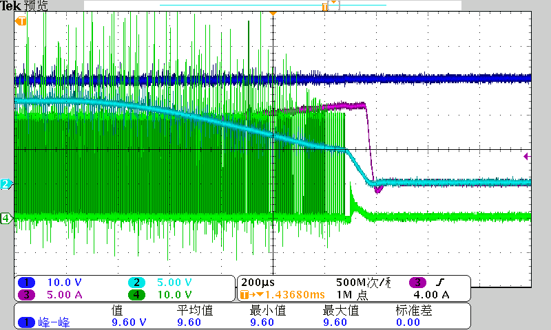

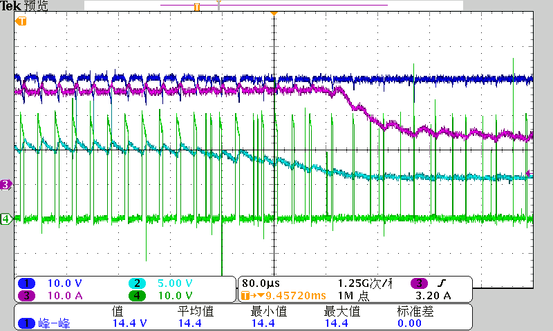

Find Over Current Protection Failure here.
Seems on issue board, switching not stopped, and have several acyclic pulse (just happen the position where the switching should get closed). Can you help analysis the possible cause?
CH1 Dark Blue: Input
CH2 Light Blue: Output
CH3 Pink: Output Current
CH4 Green: SW Point
Using EVAL LM5116-12:
30V IN, 12V OUT, 0.1R Load Transient Added
Issue Self-designed Board:
30V IN, 7.5V OUT, 0.1R Load Transient Added

    For a 7.5V output, I recommend not using VCCX (tie that pin to GND to disable). Also, the high-side FET has a large voltage drop based on what appears to be the SW voltage above - this indicates a high Rdson FET. And the current seems to be ~25A, quite high.
    Please confirm what each scope channel refers to in the waveforms above, e.g. VIN, VOUT, etc.

    I notice the current sense resistor is only 2mOhm. This gives a very high current limit (based on the 110mV CS threshold), especially given that the full-load current spec is only 10A.
    I notice that the output current is getting up to 30A (Ch3) in the scope waveforms above - please check that the inductor is rated for such high current. My recommendation is to select the current limit setpoint around 15A to provide a reasonable 50% margin above the rated full load spec. Retesting with such a configuration results in less stress on the power stage, lower temperature rise, and more reliable operation.
