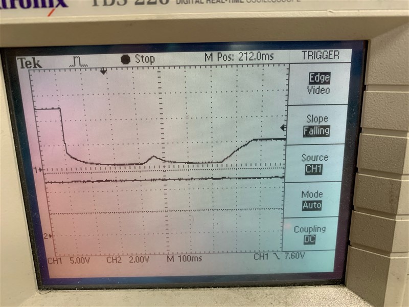

Hi team,
My customer use TPS2121 to do power mux switch, one is 12V, the other is 5V.
But there is long output voltage drop during 12V plug out period. Below is customer's circuit and testing waveform.
Please advise what is possible reason?
CH1: Sout
Ch2: USB_IN
BTW, there is loading in Sout pin and 600ms voltage drop then Sout return back to 5V.
And please also double check below schematic for strange portion.
