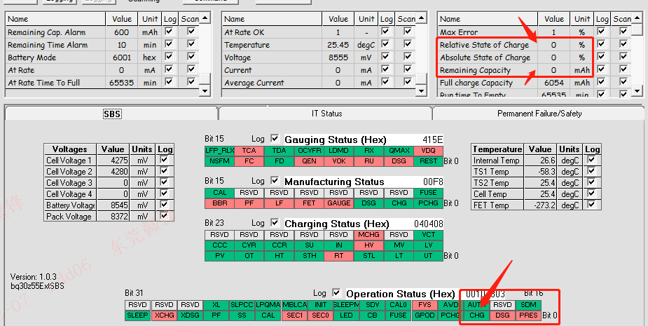

When using bq30z55-r3 two series notebook application, after charging to 100%, RSOC becomes 0%. I don't know what causes it? DataFlash sets the MOSFET to close after full charge. After full charge, the MOSFET closes normally, as shown in the figure below:

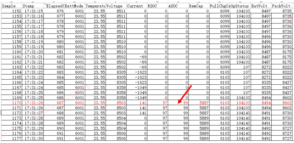

    At present, the proportion of non-performing loans is: 7 out of 100000
    The phenomenon is single, when RSOC is 100%, RSOC, ASoC and RM are all 0
    After canceling the chgfet in setting-charging configuration, the inserted charging data will return to normal
    Attached is the NG gg file

    1. The customer found it in the aging workshop during the charging and discharging aging of the whole machine
    2. When the notebook is full, low power alarm will appear
    3. The charger can not be plugged in and out repeatedly
    4. Reset command can be corrected
    5. When the battery has charging current, it can also be corrected, so turn off the charging MOS function after full charging
    At present, there is no better way to solve it. I look forward to your good suggestions, tks!
    1. At present, the zener diode is replaced by TVS zener or ESD zener at the communication end to increase the anti-static or interference ability
    2. Turn off the charging MOS function after full charging. After the charger is inserted, there is charging current and the fault will be corrected
