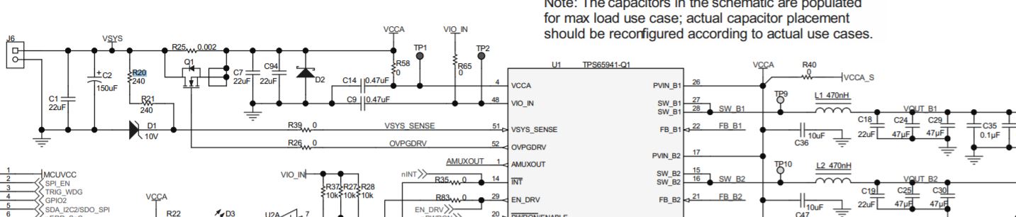

In the EVM design, the series resistors R20 and R21 are used at the VSYS_SENSE pin. Both of them are 240ohm. My customer has a question that if those two resistors can be replaced by one 480ohm resistor? Is there any special consideration here to use series resistors?

      Yes, those two resistors can be replaced by one 480ohm resistor with power consumption met. The major consideration is descried below:
      VSYS_SENSE pin serves two functions. It supplies internal 3x charge pump and VSYS over voltage comparator among few other things.
      These resistors can't be too high resistor values, because:
      1) It causes additional over voltage detection delays impairing the protection function.
      2) It causes too large voltage drop, which can potentially lead to internal supply rail to collapse/to become too noisy.

    Thanks for your reply. But sorry I'm a little confused about it. Do you mean that the 1*480ohm resistor will bring additional over voltage detection delays and larger voltage drop than 2*240ohm?

      1*480ohm resistor can replace 2*240ohm and no difference from point of view for voltage detection delays and voltage drop. You may need to use 1*480ohm 0603 size resistor to replace 2*240ohm 0402 size resistor when considerate the power consumption.
