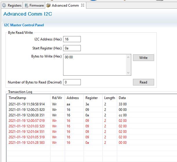

  • Hi Wyatt,
    I followed what you said. I was able to modify the c code to run on an MCU. I was wondering why it doesn't work as I completely understood how the gauge_execute_fs function parsing works in gauge.c
    Then I used EVM2400 and bqStudio to communicate with bq28z610 and try to write line by line the generated bqfs file. Start of the file looks like this.
    W: AA 3E 33 00
    X: 1000
    W: 16 09 00 00
    W: 16 0A CC 00
    W: 16 09 02 00
    W: 16 0A 00 00
    W: 16 00 00 00
    W: 16 1A DE 83
    W: 16 06 00 00
    X: 250
    W: 16 00 80 00
    W: 16 1A DE 83
    W: 16 06 80 00
    X: 250
    W: 16 09 00 00
    W: 16 0A CC 00
    W: 16 09 02 00
    W: 16 0A B8 00
    W: 16 00 80 01
    W: 16 1A DE 83
    W: 16 06 80 01
    X: 250
    W: 16 09 00 00
    W: 16 0A CC 00
    W: 16 09 02 00
    W: 16 0A 00 00
    W: 16 11 DE 83
    X: 400
    W: 16 07 DE 83
    X: 250
    W: 16 0F 22 00 40 77 2F AD BF 66 BF 91 4A 9D 3F 68 F6 B2 48 00 00 40 00 00 00 00 00 00 00 00 FF FF FF FF FF FF FF
    X: 3
    W: 16 0F 22 40 40 20 61 62 63 64 65 66 67 68 69 6A 6B 6C 6D 6E 6F 70 71 72 73 74 75 76 77 7A 78 79 30 31 32 33 34
    X: 3
    W: 16 0F 22 60 40 35 76 08 1B 33 00 00 21 00 01 00 11 54 65 78 61 73 20 49 6E 73 74 72 75 6D 65 6E 74 73 00 00 00
    And right away at the 5th line, the bms stopped responding. Exactly the same line where the MCU reports i2c error.
    Just what I was mentioning if it will work on bq28z610. I hope you can help me how to proceed with this.

  • Hi Wyatt,
    Ah, you think I was trying to flash firmware thru the Advanced Tab. That might take a week to finish.
    What I did was to check sending the first few lines of the bqfs file manually using EV2400, which is also what gauge_execute_fs from gaugce.c in the app note you mentioned is basically doing.
    Using the MCU, the bqz28z610 stops responding on the 5th line (W: 16 09 02 00)
    Using the EV2400, the bqz28z610 stops responding when I reach the 5th line as well.
    Which means there is something wrong with the bqfs file generated.
    Thanks for your help.
    Adrian

  • Hi Wyatt,
    Sorry for the late reply. I ended up with a different approach which works so far. I killed 2 ic's because of wrong flashing but i found my mistake.
    I had a logic analyzer connected to the I2C lines while flashing the srec file thru bqstudio. Every byte read and written is recorded in a file and that is what i used. Parsing the file with python and sending the commands to the MCU connected to the BMS I2C.
    The beginning of the file looks like this, right before the DF flashing starts. I inserted the delays based on the bqfs file generated from before.
    Start, hAA [ h55 | WR ], h00, h33, h00, Stop
    Delay, 1000
    Start, h16 [ h0B | WR ], h00,
    Restart, h17 [ h0B | RD ], h17, h17 NAK, Stop
    Start, h16 [ h0B | WR ], h0D,
    Restart, h17 [ h0B | RD ], h01, h91, hD8 NAK, Stop
    Start, h16 [ h0B | WR ], h09, h00, h00, Stop
    Start, h16 [ h0B | WR ], h0B,
    Restart, h17 [ h0B | RD ], h02, h00, h6D NAK, Stop
    Start, h16 [ h0B | WR ], h0A, h0A, h00, Stop
    Start, h16 [ h0B | WR ], h09, h02, h00, Stop
    Start, h16 [ h0B | WR ], h0A, h00, h00, Stop
    Start, h16 [ h0B | WR ], h00, h00, h00, Stop
    Start, h16 [ h0B | WR ], h1A, hDE, h83, Stop
    Start, h16 [ h0B | WR ], h06, h00, h00, Stop
    Delay, 250
    Start, h16 [ h0B | WR ], h00, h80, h00, Stop
    Start, h16 [ h0B | WR ], h06, h80, h00, Stop
    Delay, 250
    Restart, h17 [ h0B | RD ], h0A, h00, hC5 NAK, Stop
    Start, h16 [ h0B | WR ], h0A, hB8, h00, Stop
    Start, h16 [ h0B | WR ], h00, h80, h01, Stop
    Start, h16 [ h0B | WR ], h06, h80, h01, Stop
    Delay, 250
    Start, h16 [ h0B | WR ], h11, hDE, h83, Stop
    Delay, 400
    Start, h16 [ h0B | WR ], h07, hDE, h83, Stop
    Delay, 250
    I saw some differences compared to the output of the srec to bqfs converter from bqStudio (please see my previous post). Maybe that explains why it didn't work. Hope this helps.
