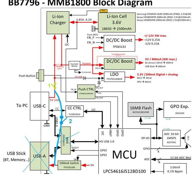

we need to modify the circuit below and thought to use 2x TPS2068 for that.
We use 2 USB ports
1x USB-C in device mode to the PC
1x USB-A in host mode for memory sticks
We want to remove the USB-A port and use the USB-C port for host / device.
• Device mode
The 5V USB from the PC goes to the LiIon Charger and supplies the whole system (up to 1.5A).
In the diagram below: Switch 1 = ON, Switch 2 = OFF. Is a default state if the uC has not yet booted.
• Host mode
The system is supplied by the LiIon battery, the system 5V comes from the boost converter, and this 5V is supposed to supply the stick in the USB-C port (blue line, currently USB-A switched by TPS2051). In the diagram below: Switch 1 = OFF, Switch 2 = ON. Switch 2 limited to approx. 600mA.
If we use 2x TPS2068 as,
Switch #1:
  • Vin to 5V USB, USB-C Port Site
  • EN# with Pull-down - Default on
Switch #2:
  • Vin auf System 5V
  • EN# with Pull-UP - Default off
Would that work in regard of „reverse current blocking“ without additional components?

  • Hi Michael, Ziv,
    would be great if you could check that on the bench. Thank you.
    it will be only for the OFF status.
    When our device works as DEVICE, it is connected via USB-C to a PC or USB Charger, S1 will be ON and S2 OFF. There will be a 5V voltage on the output of S2, as well on its input, but they can be slightly different.
    When we switch the USB-C port to HOST mode, then we open S1 and may close S2. S1 will have 0V (S2 open) or 5V (S2 close) on its input, while having between 3.4V to 4.2V on its output (LiIon cell voltage).
    In fact this is a very close application to an Laptop USB-C port with both direction charging function.
    Alen
  • Hi Alen,
    Have a test on EVM boards.
    The part only has the reverse current blocking function as IC is disabled.
    As IC is enabled, don't have the reverse current blocking function.
