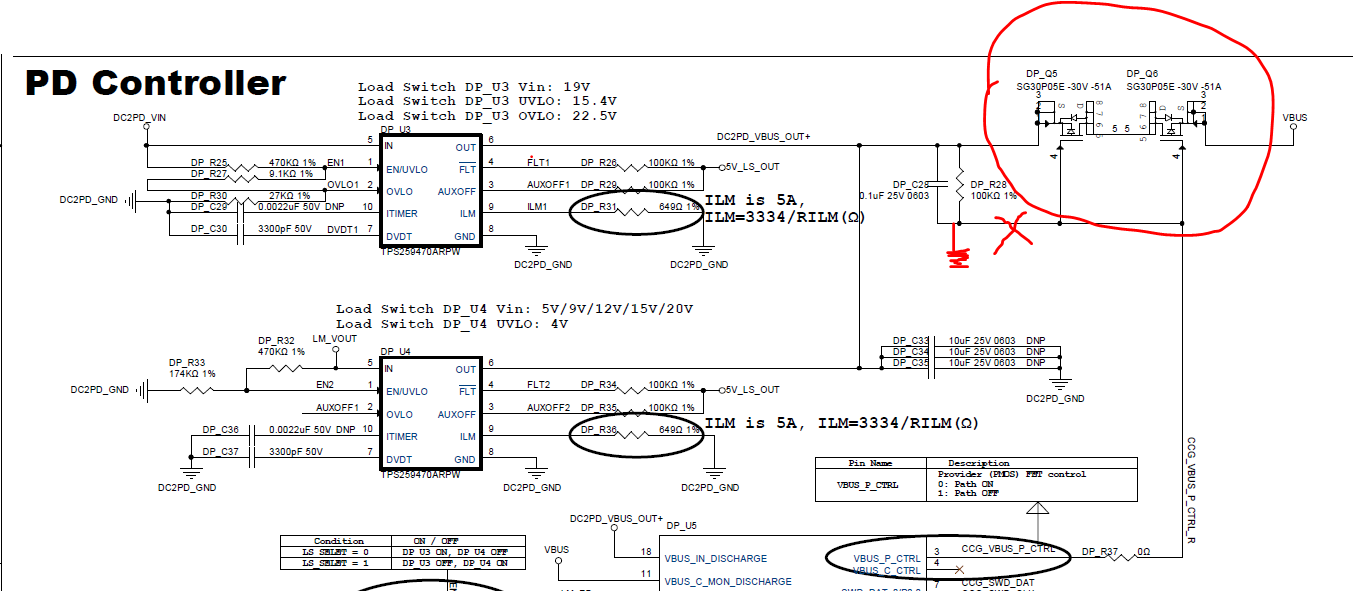

Hi
Could you  help check the TPS25947 schematic as below and any need adjust?
Thank you

  • Hi Gareth,

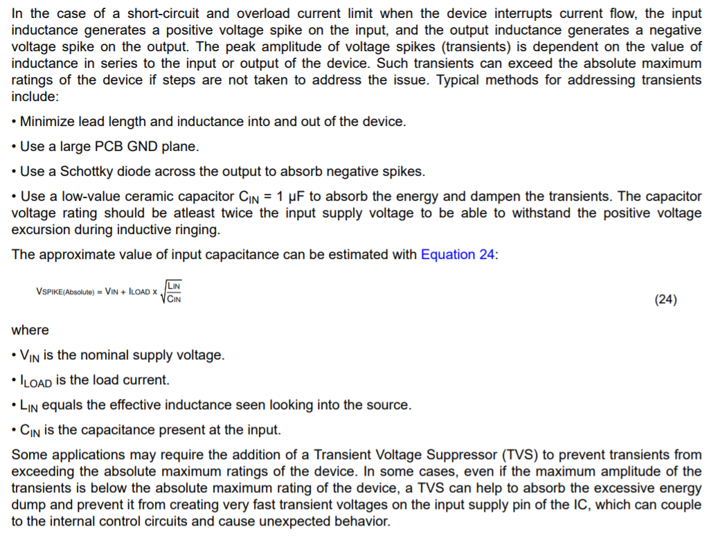

    The schematic is fine. You can take additional measures as mentioned in datasheet section 10.1 for protection from transient .
    Also I feel the output load lower end should be connected to ground instead of VBUS_P_CTRL signal like this :
    Just out of curiosity what is the purpose of two PFET at output?

  • Sorry images were not attached properly,
