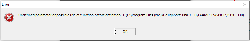

The provided SPICE model in SNOM704 has some syntax error (like duplicated pin definitions) which cause that it cannot be loaded into TI-TINA for simulation.

    Thanks for contacting us. Our model is verified in Pspice for TI. Could you try to run your simulation in Pspice for TI to see if it works? It's a free software and it provides more functionalities. Let us know if you need further help.
