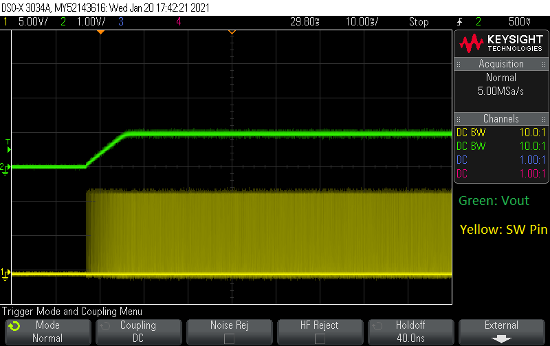

We are facing issue with LM27402 switching regulator for 1V @ 14A output from 12V input. During startup itself regulator is going into OCP hiccup mode and its continue in that. Final load to this regulator will be around 10A only.
We tried reducing the load by isolating some of the ICs at load, and still it is behaving same.
Tried changing soft start capacitor (C1500) to 1uF, even then issue persist. Please review schematic and let us know any changes required?
Attached below
1. Schematic section of 1V
Inductor part used is XAL6030-331MEB.
2. Regulator output waveform and SW pin waveform

  • Hi Kris,
    Issue persist even after replacing R936 with 0ohm.
    We have tried changing switching frequency close to 1MHz by replacing R957 with 4.7K and all other current sense, compensation and FB network remain same. In this mode startup OCP hiccup is not there, but Vout is not stable and randomly OCP hiccup and Vout is turned OFF and restarted.
    Other workaround we tried is removing around 18 x 10uF capacitors from actual load. With this reduced load capacitors and at 1MHz switching frequency Vout looks to be stable.
    Please suggest necessary modification to get stable Vout with actual load capacitor and with switching frequency around 700KHz
    Jijesh

    Before you try changing the compensation as I previously suggested, perhaps another quick thing you can try first is to change R942 to a much higher value (say 3x or 4x your current value) to set the current limit higher, and see if the hiccup behavior changes. You can do this with your original frequency and total output cap connected. Your observation that increasing the frequency helped makes me think it could still be an issue with the current limit design, since the higher frequency will lower the peak inductor current. In case you haven't yet, have you double checked the R942 resistor value is the expected 4.22kohm?

    On a different assembly same board we tried multiple workarounds as described below. Attached Vout and SW pin waveform for your reference
    Replaced R942 and R936 with 20K and the waveform is attached below.
    Replaced R942 and R936 with 10K and  R957 with 4.7K (Fadj=1.1MHz)
    Replaced R942 and R936 with 5.22K and  R957 with 4.7K (Fadj=1.1MHz)
    In all these test cases all the load capacitors are loaded as per original assembly.
    From these test cases looks like LM27402 is not able to drive required output current with high load capacitors at lower switching frequency. Or is there a way to control the load inrush current with the existing inductor and output capacitor?
    We have tried to do pspice simulation in Pspice for TI and in LTspice to see the effect of high load capacitor. In both case LM27402 pspice simulation is very slow. Is it possible for you to do a simulation and share us the results?
    Jijesh
  • Jijesh,
    The LM27402 should be more than capable of starting up into several 100uF of load capacitors.
    I ran the PSPICE transient model for your original schematic and see an oscillating output. I used a small Css capacitor to speed up the sim.
    I then updated the compensation components with values from the Excel calculator (increased the output cap from the previous version I sent before) and got a more stable startup waveform:
    Can you try the updated compensation network?
    If you still see do not get a stable output, can you please take the oscilloscope shots again and capture the input voltage as well.
