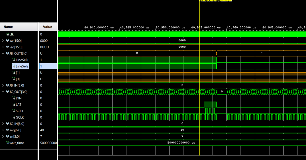

2. when and how do I send the VSync command? Currently I send it, during the last sub-period, before switching (see screenshot). Is this correct or do I need to have GCLK pause first? Do I need to be able to turn off the lines completely externally? (I can control with 2 bits the four lines, so one is always on...)

    2. You need to pause the GCLK before sending VSYNC. And after receiving VSYNC, the device will reset the GCLK counter, and the device will start to display again. And it doesn't matter which line is choosing at this moment, since no channel turns on.

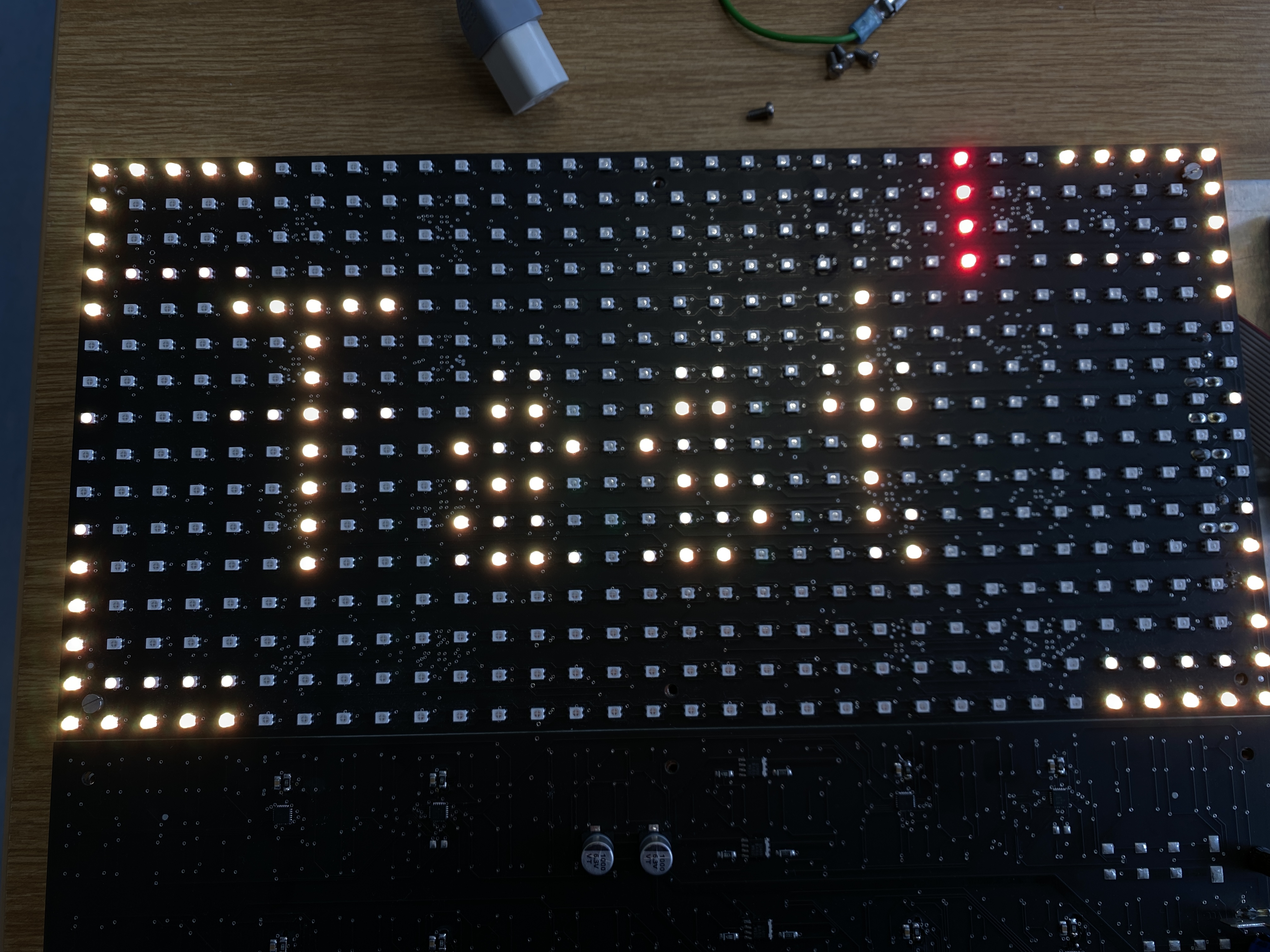

  • Hi Shawn,
    flicker is perhaps too strong a word.

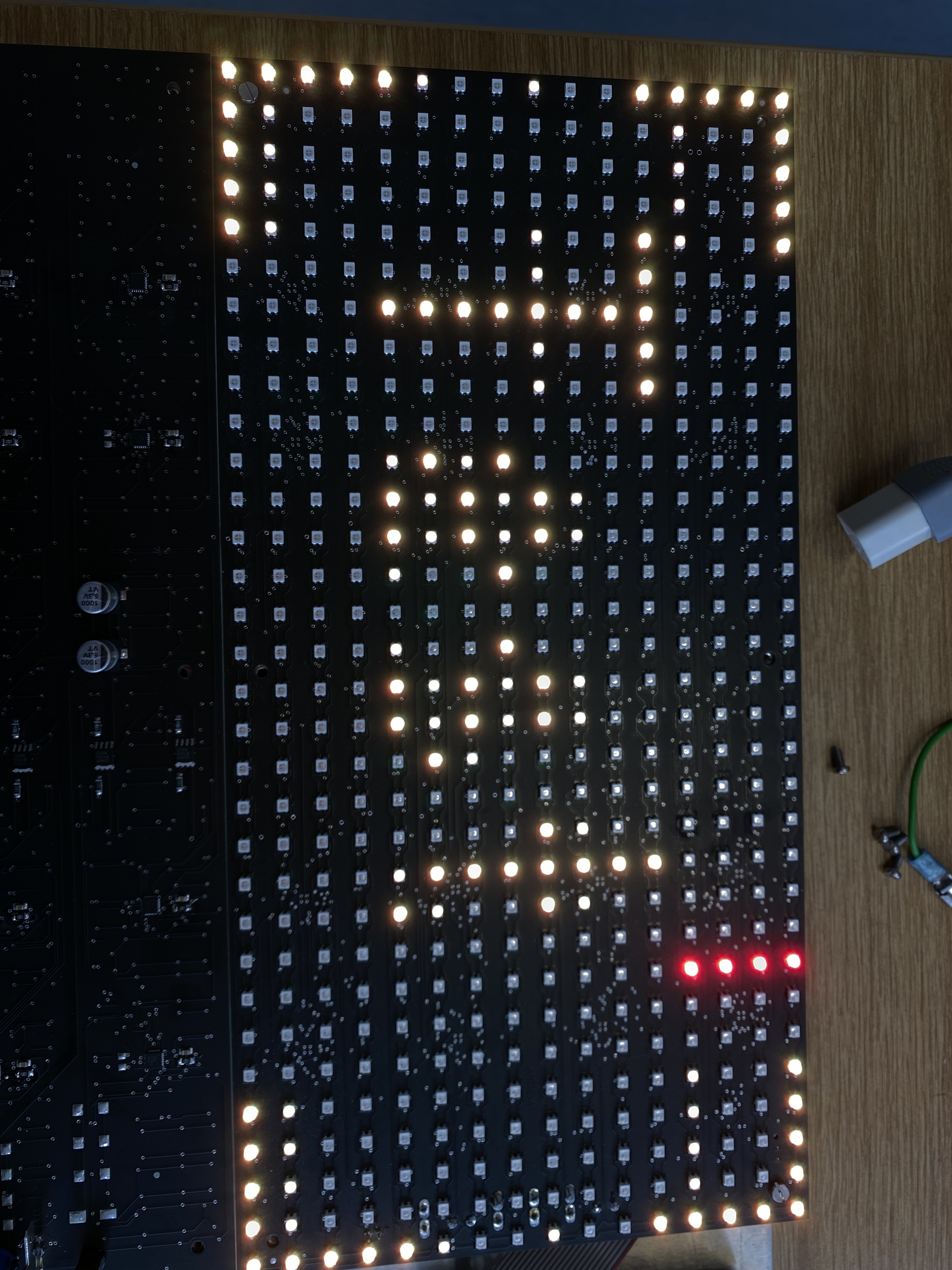

    Lines that are not supposed to be lit always light up faintly. The content of these is that of other lines of the same driver.
    In the picture you can see this for example in the upper left corner. In line 1, 5 LEDs should light up, these also light up dimly in line 4. And I don't know where this comes from.
    Can you help me further on this?
    In addition: 1 driver always drives 16 x 4 LEDs, so on my board there are two drivers next to each other and four below each other.
    Michael
  • It seems the upper side ghosting. I suggest you to connect a Zener diode/  1000ohm Resister on each line to GND. it will supply a discharge path for line.
  • I have done this but it does't remove the effect. Any further idea?
