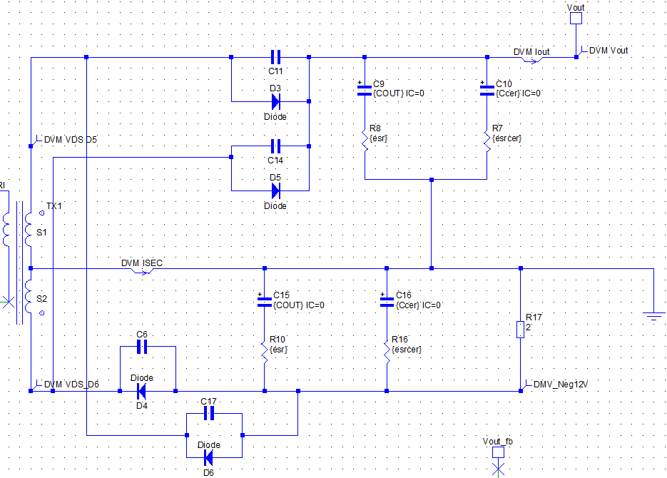

A customer of mine has a question regarding the regulation capabilities of the UCC256403 under certain circumstances.
Above is a capture of the LLC Half Bridge schematic. The feedback loop is set to monitor the +12V.
The question is, if the +12V output is loaded to 10A, and the -12V is unloaded, can -12V output stay regulated within +/-3%? And vice versa, if -12V is the one loaded and +12V is unloaded, can the +12V output stay regulated?
