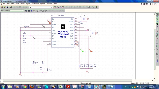

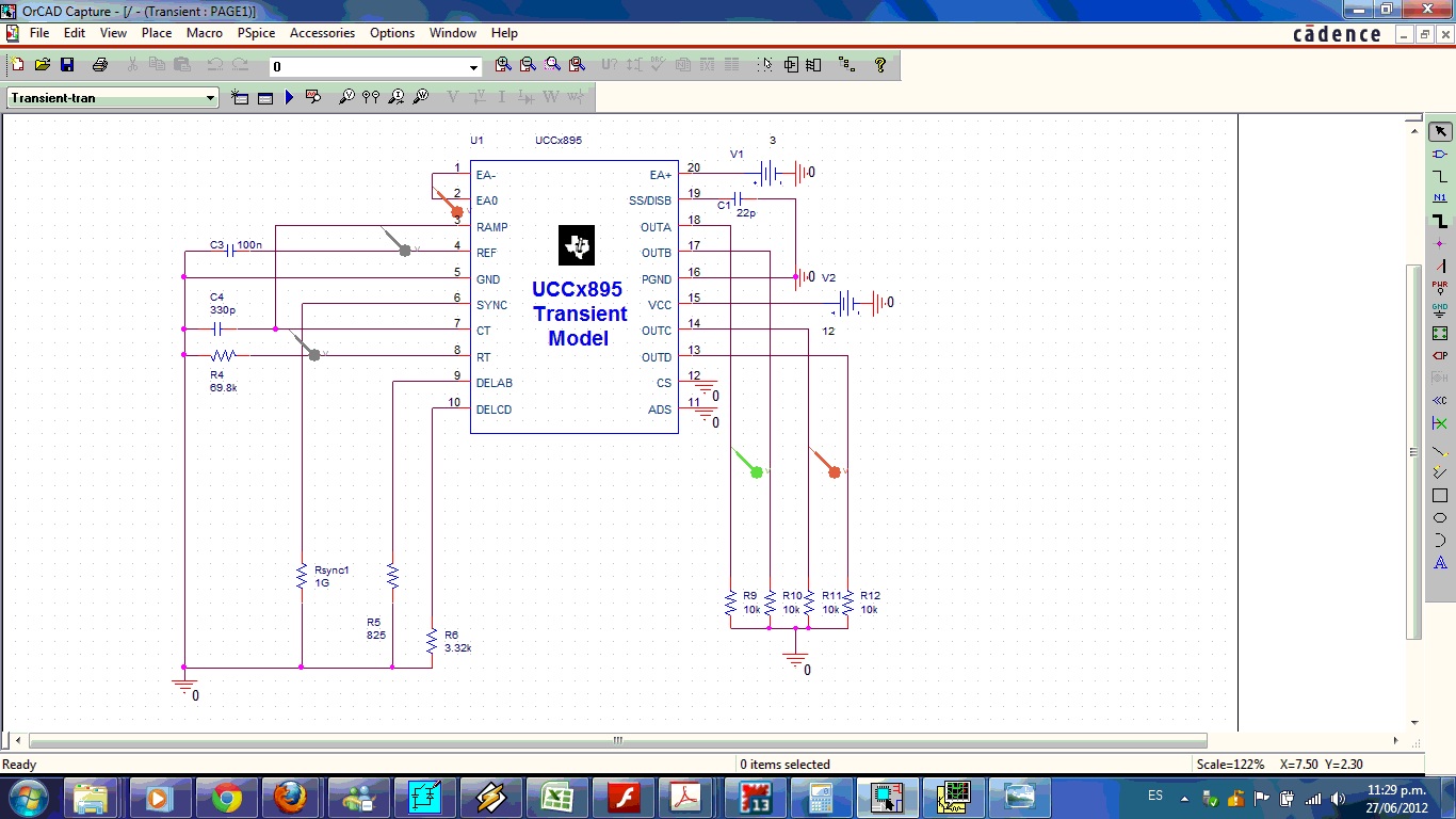

  • UCC28950 is not working in Orcad (open loop operation). However UCCx895 is working. I leave you the diagram.
    Best regards
    René
