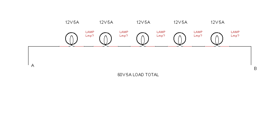

  • Sir,
    Below is the schematic diagram of the connection.
    The load bank at point A, B looks like below
    When we tested the load bank at lower voltage of 50V, there was no heat across Mosfet, the load current was around 4.16A. We even tried turning ON/ OFF multiple times to see if back emf was a problem. But nothing happened at 50V.
    Power dissipation depending on Rds which is ~~ 5mOhm at gate voltage >10V.. Then  4.16 x 4.16 x 0.005 = 86mW which was true.
    This mosfet is capable of running up to 100V according to datasheet. We raised the voltage to 60V gradually to check at 5A load current which works fine. However if we start same system with same load ratings at 60V, the mosfet behaved liked short and since then it was short even after power off and even after removing mosfet it showed short.
    Calculation wise 5 x 5 x 0.005 = 125mW has to drop across mosfet and should had been stable. But for some reason Drain and source shorts.
    Some videos on youtube explain a phenomenon called avalanche breakdown of internal diode across PN of mosfet due to slow discharge of high back emf voltage across load when connected to inductive load. I hope its not what's happening here.

  • Hi Macjan,
    Thanks for the update. I recommend capturing VGS and VDS waveforms with an oscilloscope at turn-on and turn-off of the system. Please capture multiple waveforms showing the rising and falling edges. You're not seeing any issues when the supply voltage is gradually increased with the FETs on but the failure occurs after system startup or shutdown. One or both of the FETs may avalanche during these transitions. TI specs single pulse avalanche in the datasheet. The other consideration may be an SOA (safe operating area) violation during turn-on or turn-off of the FETs. You have a large gate resistance, 100k + 10k at turn-on and 10k at turn-off. I'm including links below for more information on how TI tests and rates avalanche/UIS and SOA for our FETs.
