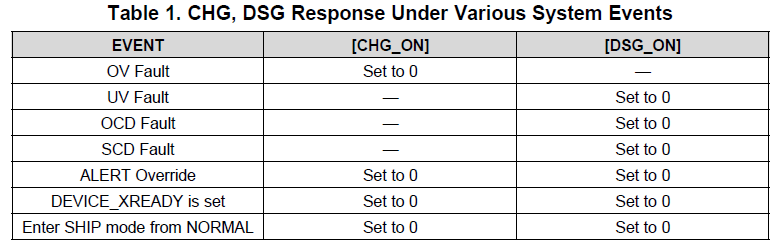

4.Once the AFE detects a fault, immediately AFE sets the state of DSG and CHG mosfet as per below table without the interventions of the host controller?

    4. Yes.
