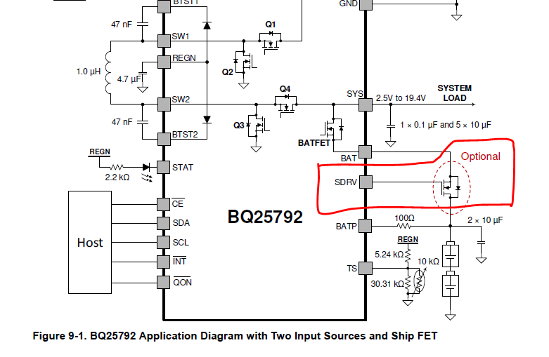

Hi Team,
I want to understand how the mos shown below is driven? Is there a bootstrap circuit or charge pump inside? In the process of helping customers to test, I found that the driving ability of SDRV is very weak, but it can work. Can you tell me more about this mos?
