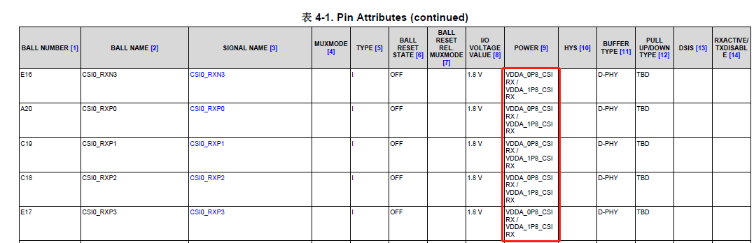

As shown in the figure, the CSI module of TDA4 requires 0.8V and 1.8V power supply. The actual working level of the CSI interface is only 1.8V, right?

Both rails are used in the system. The 1.8 V rail is used for bias while the 0.8 V rail is used for digital functions.
