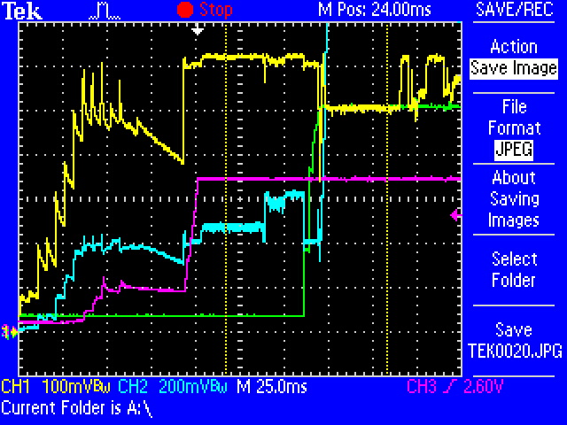

In the latest batch we've noticed that some TPS43061 devices on wake-up consume large currents from the VIN pin and do not functioning properly. The failure is intermittent (happens after multiple tries) and even when happens, the device eventually wakes up after a few seconds. When the failure does occur these are the symptoms that we see:
1. Large current consumption into VIN pin (>100mA)
2. EN pin remains low (internal pull-up not engaging)
3. VCC pin goes high immediately with VIN (normally the internal LDO should be disabled while EN is low)
4. SS remains low
5. HDRV pin goes high (to the same voltage as VIN)
Replacing the TPS43061 on one of the failing boards solved the problem. We would like to understand if this failure could have been caused by improper handling at the manufacturing facility, or whether there is another explanation to the failure.

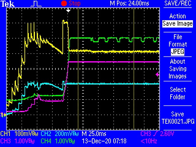

    This is an example of a failed wakeup. CH1 is the input voltage. CH2 is the output voltage. CH3 is irrelevant. CH4 is the voltage supplied to the VIN pin (separate from the converter input voltage) at a scale of 1V/div.

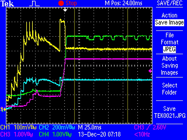

    Here I'm probing VCC pin voltage instead of VIN pin on CH4 during failed wakeup:
    The HDRV voltage also rises together with VCC. The EN pin is held low when I see the VCC and HDRV rise. During normal wakeup both VCC and HDRV are low when EN is low.
    From my analysis so far it looks like the TPS43061 received some kind of damage. I'm trying to figure out what kind of damage that could have been.

  • CH1: input voltage, CH2: output voltage, CH4: supply voltage (VIN pin)
    CH1: input voltage, CH2: output voltage, CH4: VCC pin
    A few details about the circuit:
    Input voltage: 0.5V
    Output voltage: 5V
    Load: no load
    Supply voltage (VIN pin): 5V

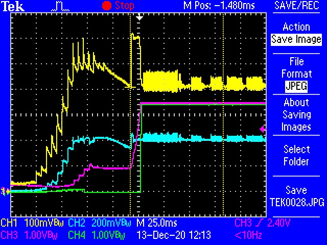

    Correct wakeup looks like this:
