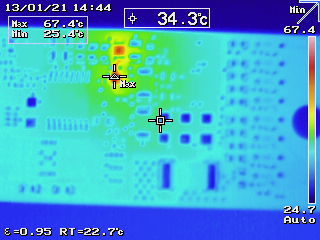

Have been testing a design using the BQ76930 & BQ78350 and it has failed such that the BQ76930 was running hot and discharged the battery overnight.
The pack had been charged and then discharged to ~30%.
Charger power output had been accidentally shorted the day before.
Pack was disconnected overnight and when going to reattach the device it felt warm.
Top of board (BQ76930 U1 hot)
The heat source at the bottom left is the opposite side of Q5 / R73 shown below.
Bottom (REGSRC FET Q5B and resistor R73 hot.)
The 2.5V rail was not regulating. Battery had dropped to very low voltage before this was noticed.

    You don't mention the voltage of REGOUT other than it was not regulating.  From the thermal picture I suspect the REGOUT was shorted either internally or externally. The hot spot on U1 is likely the pin 1 end since the regulator is near that end.  If there were no hot traces on REGOUT it seems it would be internal.  Semiconductor devices can experience a condition called latchup, ICs are designed to avoid it and tested in qualification to be sure they are not sensitive to it.  I'm not aware of any sensitive of the BQ76930 to it.  There are occasional reports of cells drained without explanation.  The common trigger for latchup is high current from IC pins, so your observation of VC0, VC1 below VSS is a concern.  Customers have reported damaging ICs from such voltages.  It seems you have prepared for that with the TVSs on SRP, SRN and VC0. Having a negative on VC1 seems to indicate a large transient.  I don't recognize anything unusual in your schematic.
    From your description of results it sounds like it is an uncommon condition.  Adding the Schottky diodes you described seems a good plan.  Please let us know any further observation.
