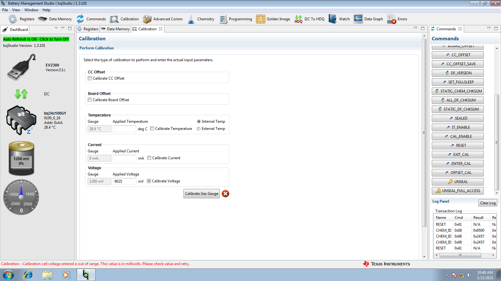

  • Calibration tab - voltage calibration (Here I got an error: voltage is not in a specified range. the range given is in millivolts.
After getting this calibration error, the device just bricks!! I lost 3 ICs just like this.

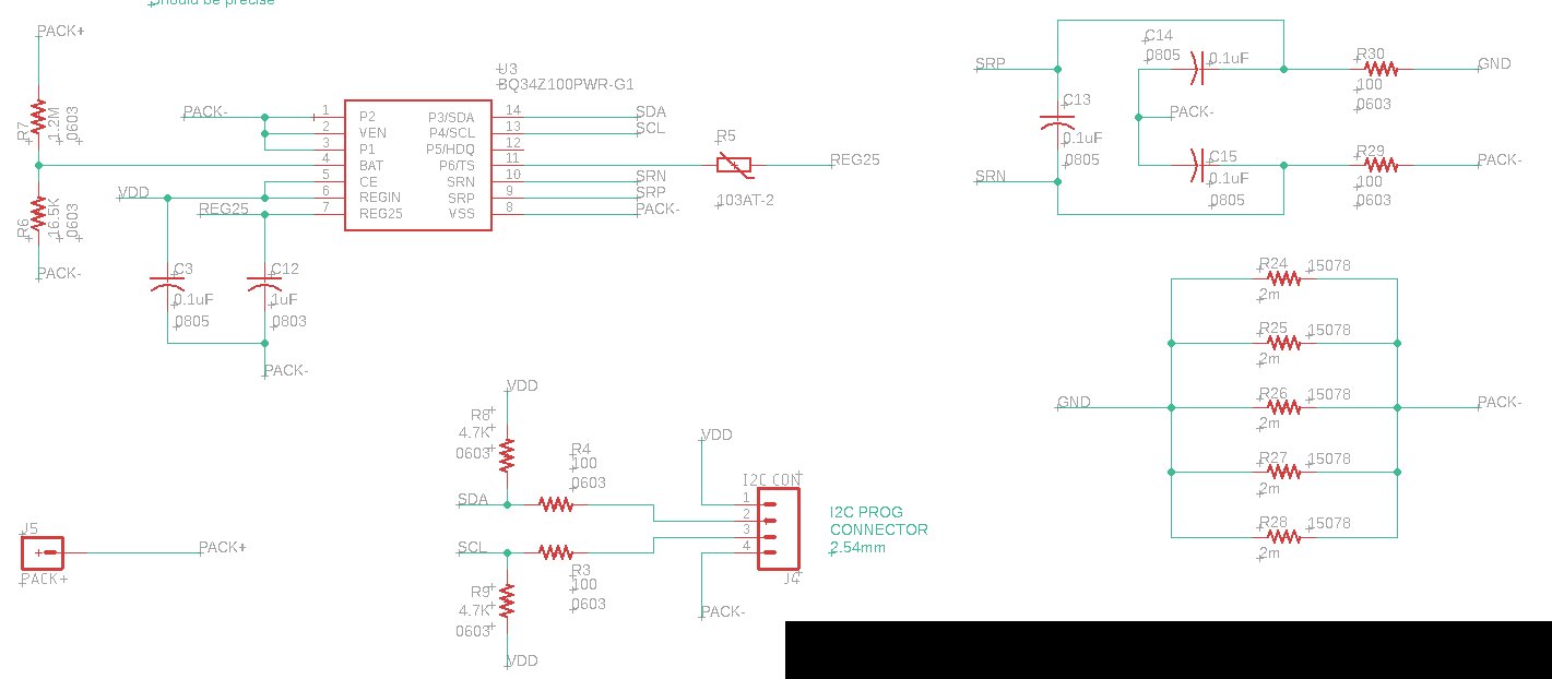

  • Here is the reference schematic.
    GND is VBAT- for the following schematic as per the TI conventions.
    Please provide details for obtaining the .gg files.
    Also, is there any way to validate whether the gauge is damaged or not? I checked REG25 pin of the unresponsive ICs and it provides 2.5V, but the SDA & SCL line voltages appear around 1.5V even though a 4.7K pull-up resistor is connected which is strange. (My VDD is 3.3V)

    Are there any other devices on the comm lines? I may try increasing the pull-up resistor to 10K. Was the voltage 1.5V on the bricked board?

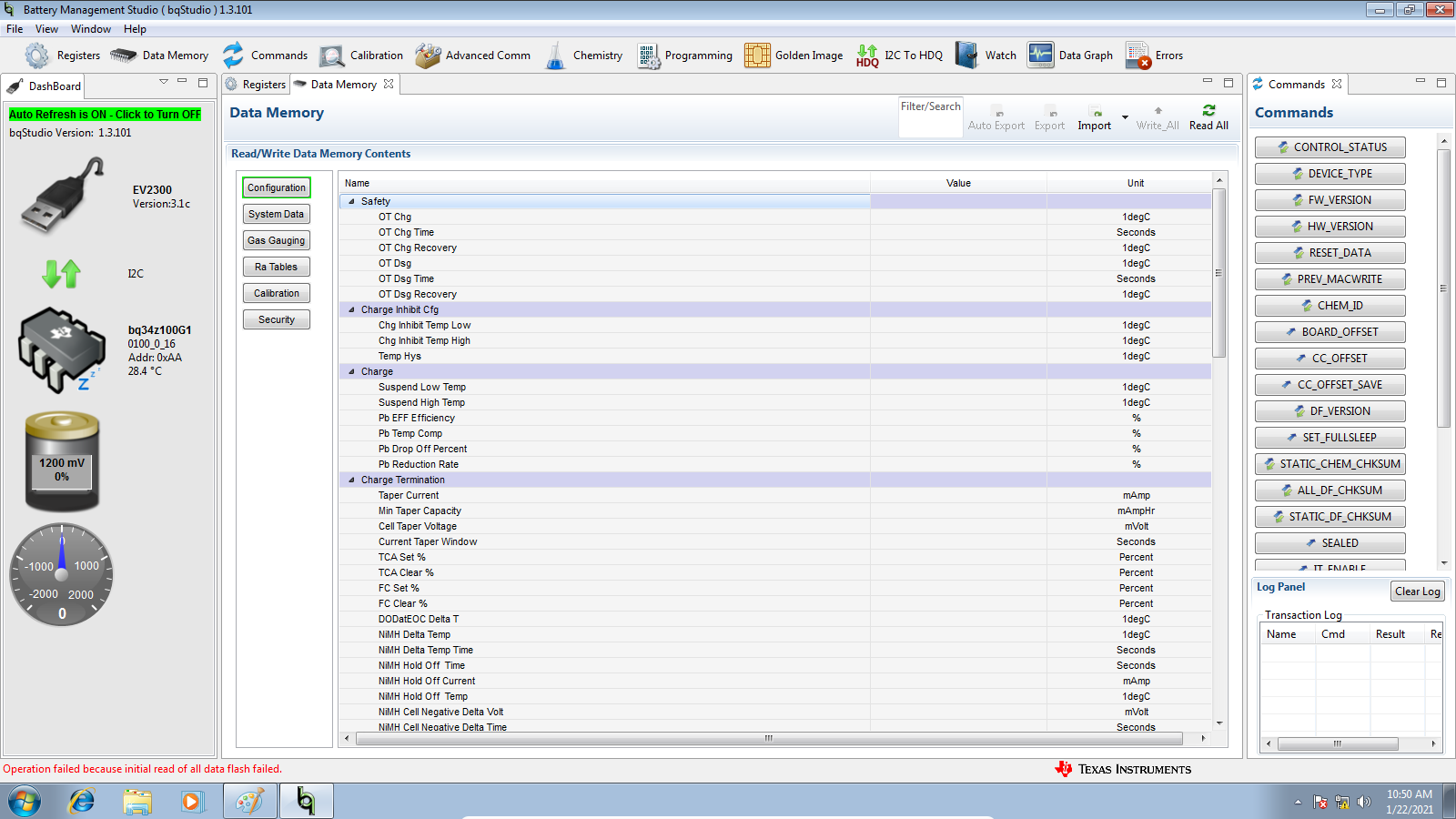

    Here are some screenshots to illustrate the problem:
    1. When the Data Memory tab is open or Read All is pressed, a Similar error appears 3-5 times but then the device gets read in the subsequent attempt.
    2. Error occurred while performing voltage calibration. This error doesn't go away even after multiple attempts.
