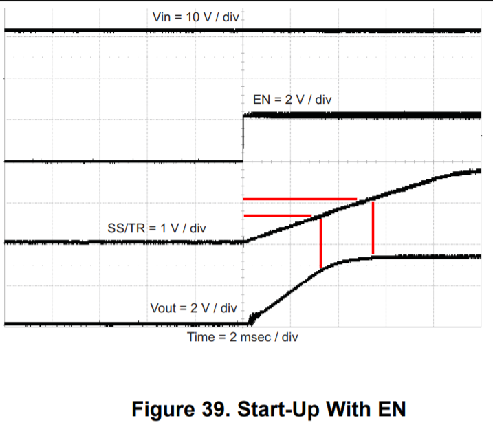

    1. There is some offset between the SS/TRK pin and the regulator FB voltage (30 mV typical) so the output voltage regulation is slightly less accurate.
    2. The SS/TRK pin needs to go above 1.4V worst case for the PWRGD pin to go high.
    3. There is a knee in the SS/TRK vs FB voltage as the SS/TRK voltage approaches 0.8V. This transition happens from ~0.7V to ~1.1V on SS/TRK. I have pointed this out in the waveform below from the datasheet. The TPS54622 (or the newer TPS54824) would have a sharper knee if this is a problem.
    I think these devices are the only ones with the tracking feature to meet this requirement. So, another advantage of doing this through the FB pin is it would enable some additional solutions. However another one of the requirements for this application which starts to limit the devices that can be used is the 8-V output.
    Will the SS/TRK pin meet the needs here or would they need to do something through the FB pin?
