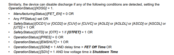

    The DSG flag in GaugeStatus should only be set when the gauge is discharging or relaxed. You may want to check your thresholds (like quit current, relax times) if this bit is toggling often.
    Sincerely,
    Wyatt Keller
  • Here's what I want to know:
    Even if the battery (gauge IC) is operating CUV, OCD, is it normal for DSG to become H when charged (even if CUV, OCD is operating)?
    The reason I want to know this is because I am trying to program the machine as follows.
    (1) Monitor the DSG.
    (2) If the DSG becomes L, it is judged that the battery is in an abnormal state (the protection circuit has worked).
    (3) After that, when the DSG becomes H, it is judged that the normal state has been restored (the protection circuit has been released).
    However, this method cannot be used because the DSG becomes H even if the protection circuit is not released.
    Therefore
    (1) Monitor DSG, XDSG, SS.
    (2) If XDSG is H or DSG is L or SS is H, it is judged that the battery is in an abnormal state (protection circuit has worked).
    (3) After that, when XDSG is L, DSG is H, and SS is L, it is judged that the normal state has been restored (the protection circuit has been released).
    I will take this method. Is there any problem with this method?
    further
    Does XDSG remain H during protective operation (CUV, OCD) (does it not change until protective operation is released)?
    Is SS (CUV, OCD) still H (does it not change until the protective action is released)?
    Please tell us about these two as well.
    I would not use the DSG bit for determining a safety event.
    If you monitor the XDSG, it can be set from many different ways:
    It will clear when the safety status clears. The SS bit would be most useful for looking if any of the safety status bits are set since it OR's all of the bits.
