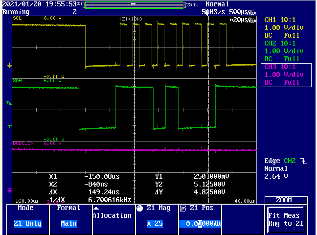

Dear guys.
I evaluate TPS55288.
Attached waveform is slave address setting.
This waveform mentions No ACK signal from TPS55288.
What kind of cause can be guess?
Slave address is  74h.
Mode pin is pulled down with 0ohm resistor.
SLC and SDA terminal of MCU has 2.2kohm pull up resistor.
Each line has 100ohm damping resistor near by terminal.
Please let me know if you need more detail.
Yellow : SCL
Green : SDA
Pink : EN signal
