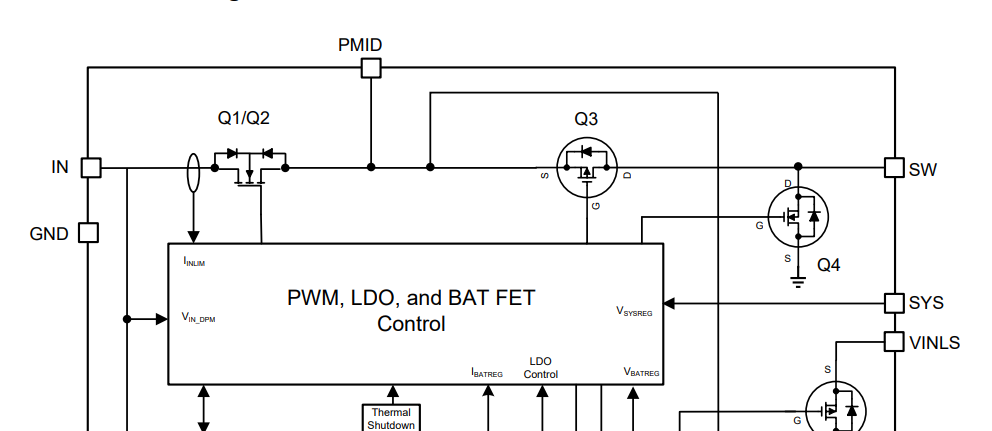

Hi If I have a disabled wireless charger device like BQ51003 connected to the BQ25125's input,
how much reverse leakage current at the BQ25125 input due to the input loading can I expect.
The BQ51003 datasheet specs a 20uA quiescent current at the output when wireless power is disabled (Standby).
Would the BQ25125 input blocking FET limit this quiescent current even more?
-Kelvin
