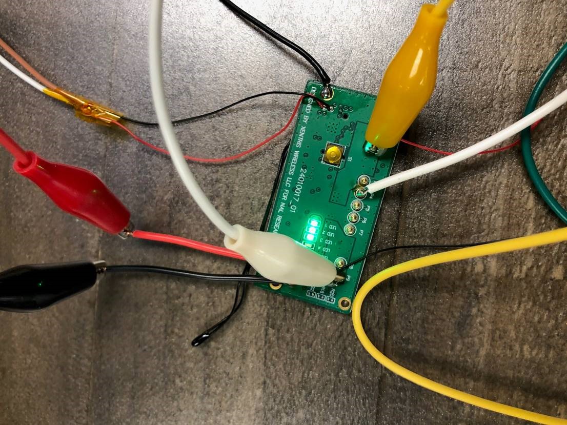

A customer is having a few issues coming up with bringing the BQ40z50 online and I was hoping you could assist in answering a few questions and debugging this problem.
The good news is the PCB powered up and communicated with the TI BMS software tool. I used Rick’s firmware package for a 1s2p configuration and adjusted the firmware for my application.
Unfortunately the PCB is not charging the battery cells.
  • With the power supply off the cell voltage appears at the pack +/- pins: 3.6V.
  • The LED’s light but do not flash which indicates it is not charging (also the current on the power supply is only 0.04A)p
  • The pack present has to be tied to GND.
  • The LED’s should only work when the pushbutton is pressed.
Here are some screen shots and photos….I am new to this firmware, there are a lot of features and maybe I missed something.
  • The firmware did work on the EVM but the EVM and my boards are not 100% the same. Also, I checked several of my PCB’s and they all have the same result. I checked the components on the PCB and for shorts. Everything is ok. The design was copied from a working project.
  • Another strange thing is when I shutdown the PCB and disconnect; then reconnect the PCB to the bqStudio it will not connect. I will check the Vout which should be 3.6V and it will read zero but I will tear down again and reconnect again and then it will work. Strange. This is consistent.

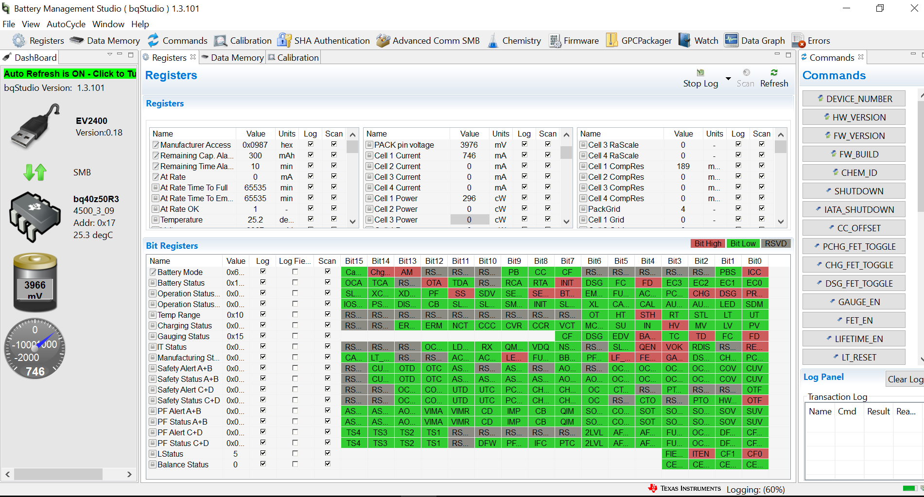

    The xchg and xdsg bits would indicate if the fets were off, but in this case they are 0 so charging should be allowed. Is there a battery charger also on this BMS?

    The OTF bit is set, this means the chg/dsg FETs have overheated.
  • Hi Nick,
    The DSG and CHG FET's on the PCB are not getting hot. The OTF  bit turns high (red) immediately after connecting to the TI BMS. From your experience have you heard from another customer or witnessed this happening immediately on startup? What indicates to the BMS IC that the FET's are too hot?

  • Hi Nick,
    Attached is the screenshot of the registers while I was charging.
    David
  • Hi David
    I'm not aware of any mechanism that the gauge could be causing the charger to not output its rated current. Also The logs show a spike in current/voltage that we don't normally see.
