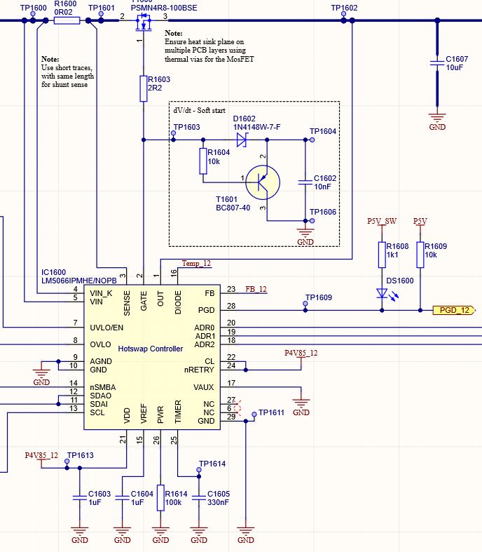

LM5066IEVM-626 board was modified to our needs.( VIN=28V; Max. current = 3A)
Modifications performed on the board:
  • Q3,R5,C5 were removed.
  • other components were replaced according to the attached calculation tool.
If load is applied to the output after S1 is ON, everything works as expected.
If load is applied to the output and S1 is turned ON afterwards, startup is not performed. LM5066I in the presented configuration is able to drive 0.6 A only. Above 0.6 A I receive over current fault, and the output is disabled.
In my application I need to supply a permanent load, which is always connected to the output of LM5066I. The load can not be enabled or disabled, it is switched on by the LM5066I output.
PLim is nearly double as the calculation tool suggests, due to the fact that load is available on startup.
Could you provide some hints, in order to find the issue.
Thank you!
Alpar

  • Hi Alpar,
    Welcome to E2E!
    What is the type of load and at what voltage the load turns-ON?
    Remove soft-start capacitor C1, set higher power limit such as 110W and test again.
    Please share start up test waveforms Vout, GATE, Timer, input current
    Best Regards, Rakesh

  • Hi Rakesh,
    Thank you for your support. Setting higher power limit solved the issue.
    Could you provide information regarding maximum current sink capability of PGD and nSMBA pins?
    I do not find any information in the datasheet regarding pin current sink capability.
    It is only mentioned that during test conditions current sink was 2 mA on PGD and 3 mA in case of nSMBA.
    Is there an explanation why the LM5066IEVM-626 uses 100k pullup on PGD pin?
    In my design I would like to add LEDs to these lines without using any other external components.
    P5V and P5V_SW are the same power rails, P5V_SW is interrupted with a jumper.
    Thanks!
    Alpar
  • Hi Alpar,
    Good to know that.
    Usually customers prefer higher pullup resistor to reduce the shunt current. For the same reason, 100k was used on EVM. Please treat 10mA as maximum current sink capability of PGD and nSMBA pins.
