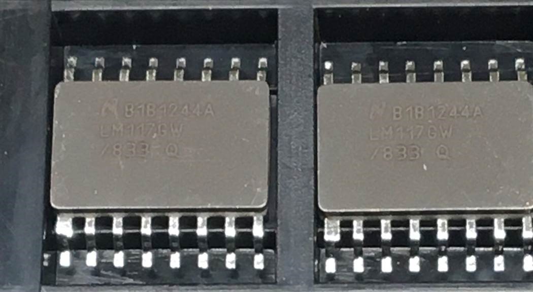

The part is marked /833 vs /883. Can you please provide documentation that these parts are valid /883 parts from TI?

Will you help to provide the complete orderable part number with this top marking in question? If possible, will you help to provide any lot/trace code information that normally labeled on the packing of the parts?

I am passing this to our quality team and please allow some time to investigate this. The system only shows the top marking for 883 and I cannot confirm anything that would come with 833.

Quick update here, we are investigating this through the manufacture, and please allow some additional time for us to complete the investigation.

We've completed our investigation. We were able to locate all the manufacture data for the LOT number as shown in the conformance. But we can’t connect that to the material since its top marking doesn’t match. To answer your question, TI cannot verify the authenticity of the material in question as there is no record of an LM117GW/833 material.
