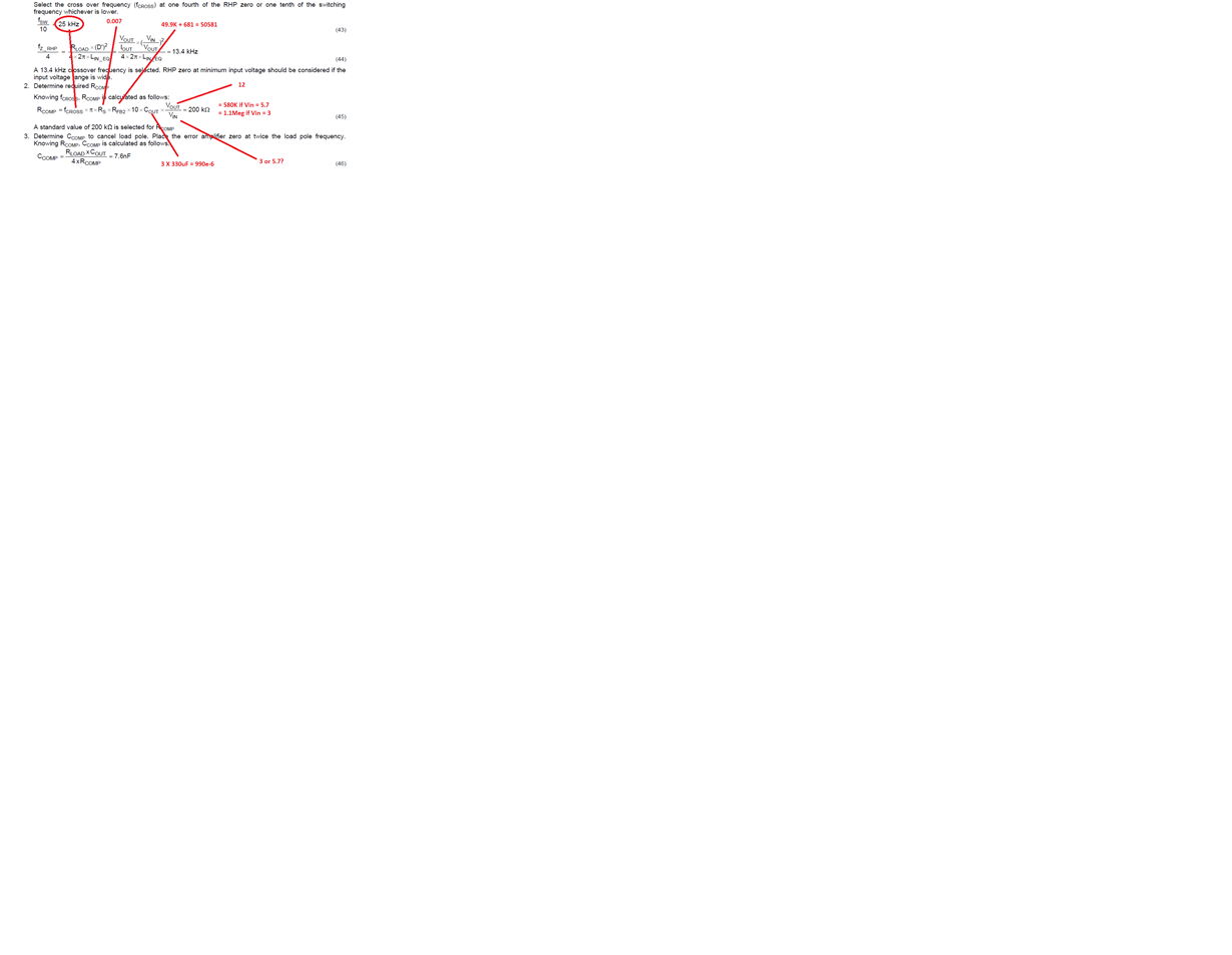

I think Equation # 45 in data sheet for calculating Rcomp is wrong.
Please see attachment.
  • Hi Li,
    I just verified in Mathcad that the datasheet info is basically correct: the result is ~196kOhm.   Note that Vin uses the typical Vin of 9V.  It also clearly mentions in the paragraph below Equation (44) that fCROSS is chosen to be 13.4kHz, not 25kHz.
