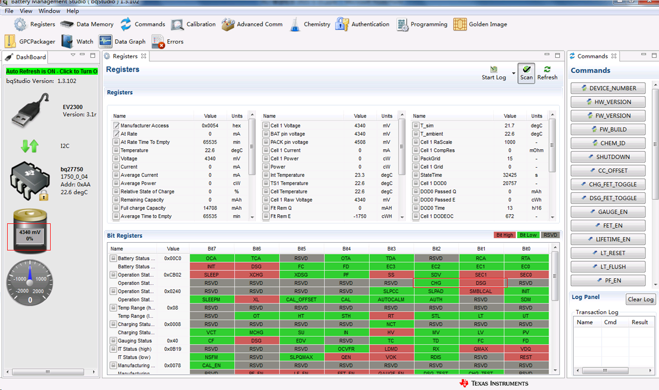

Customer return battery: The customer's use environment is about -10℃, The battery is fully charged, but the SOC shows 0% power, After sending the RESET command, the battery returns to normal.
Hi Scofield,
Can you attach .gg and logs.
How many packs have been returned like this. Can you replicate the issue.
Hi Nick Brylski,
The customer returned 2pcs and there is no logs data yet,I am doing reproduce this problem
Hi Scofield,
It may be related to the low temperature, did you find the chemID with GPCRB?
