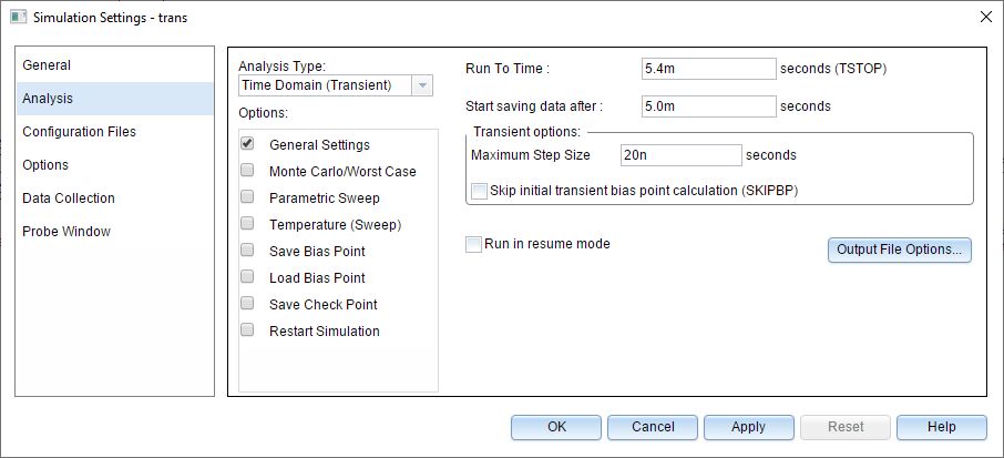

Hi Team,
I regards to the TPS54040A, my customer have noticed some odd behavior when simulating the part. I have attached a screenshot of the output voltage from the PSPICE transient simulation available on your website (https://www.ti.com/lit/zip/slim069) of the output voltage after 5ms, we haven't changed anything in the simulation schematic that's available online except for increasing the simulation time. I would have expected that the voltage will have reached steady state after 5ms and the output voltage waveform would be relatively constant with just the filtered switching ripple superimposed. The simulation is showing a lower frequency oscillation, perhaps this is noise, we have some concern about this and are wondering if someone in your team could explain why we would be seeing this?
 Thanks!
