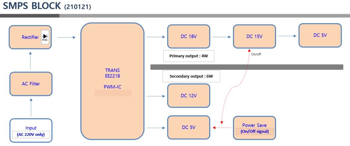

SMPS block review applied to air conditioner model is in progress.
We ask for confirmation with a PWM IC with low standby power.
Please check the information below and request a suitable PWM IC recommendation.
- Output capacity: 15W (Based on actual load : 10W)
- Standby power: Between 10mW and 20mW or less.
  (No-load at 230VAC when supplied transformer bias, DC18V (primary), DC12V (secondary), DC5V (secondary) voltage must be alive.)
- Integrated FET or External FET (Does not matter)
The SMPS block diagram is as follows.
  • Grady,
    Thanks for considering TI here!
    If you want secondary side regulation, I would consider UCC28740 here. If you prefer primary side regulation (no opto), take a look at UCC28730 which is lowest standby power in the industry for AC/DC Flyback.
