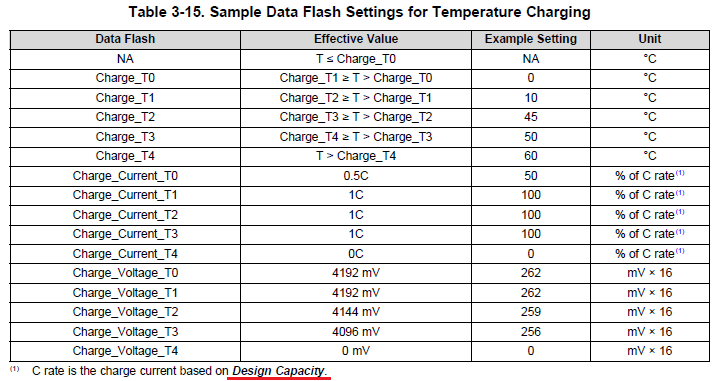

BQ27531-G1 TRM shows the following.
If my customer set as Table 3-15 and then temperature goes less than 0℃ or more than 60℃, does BQ27531-G1 automatically disable BQ24193 to charge?

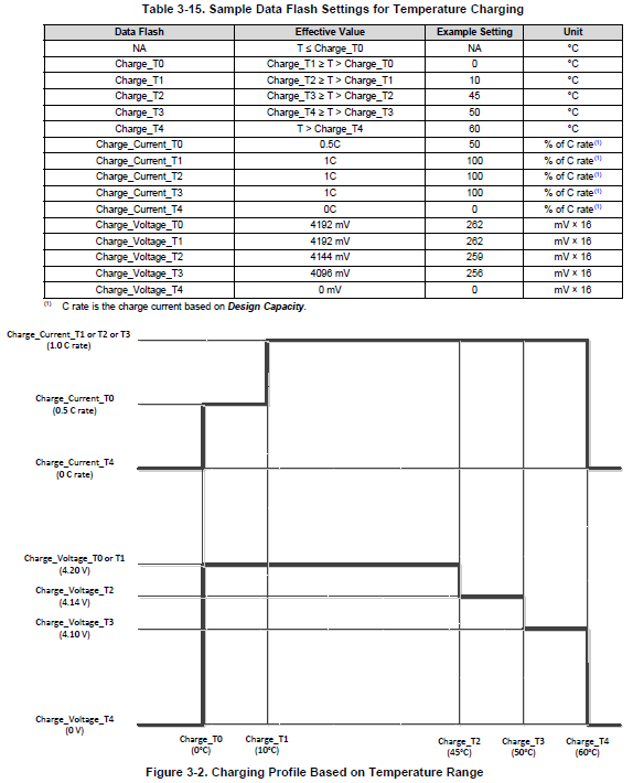

    I would like to ask an additional question.
    Regarding Table 3-15, it shows the unit of Charge_Current_Tx is based on Design Capacity.
    Is it true?
    My customer said AverageCurrent() shows about 800mA although he set Design Capacity=1100[mAh] and Charge_Current_Tx=50[%].
    Is it possible case? I think expected AverageCurrent() is about 550mA, so would like to confirm just in case.
    I also heard CalcChargingCurrent() and ProgChargingCurrent() shows 1024[mA] in this case.
    Yaita
  • Hello Yaita-san,
    Yes it should be based on the design capacity, the CalcChargingCurrent() is what the gauge wants to charge at, so something with the battery/charging is not allowing the max charge current.

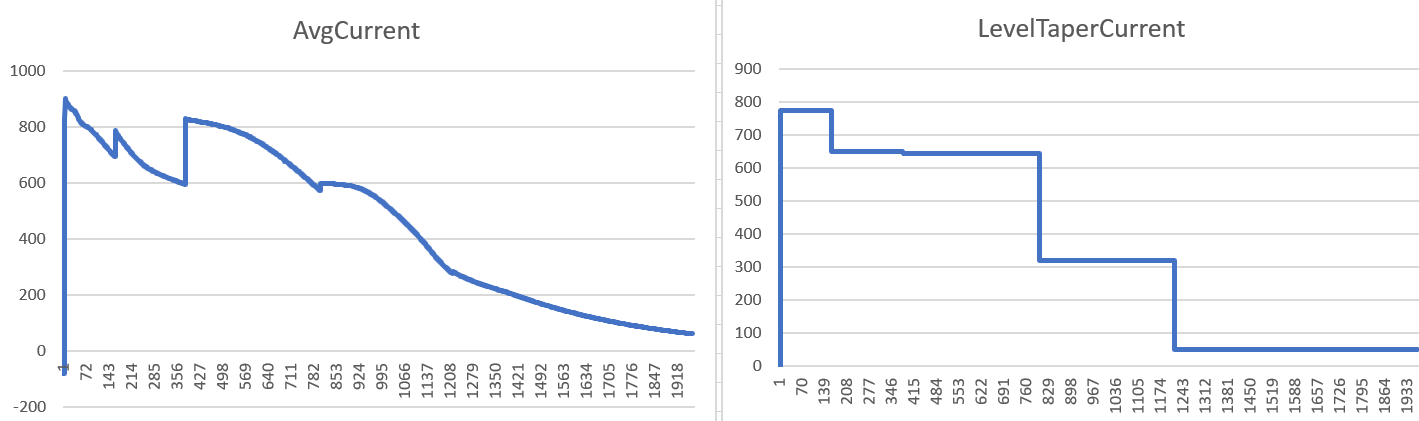

  • Hello Yaita-san,
    It looks like the charger is in the constant voltage phase, the current is can change dynamically as the temperature changes (which it looks like it's doing from the logs)
    Every time the taper changes the current also changes, if it was in the CC region I would expect it to be what your customer is expecting.

  • Hi Wyatt-san,
    Thank you for your reply.
    Do you know why AvgCurrent goes up to 800mA with the setting of BQ27531.gg.csv?
    Is it unexpected behavior for my customer and he wants to decrease the charging current.
    Yaita

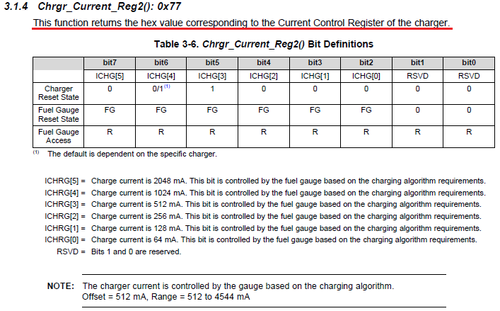

  • Hello Yaita-san,
    Please try setting the 3.1.4 Chrgr_Current_Reg2(): 0x77 to 0x00, I believe the offset is causing the issue you're seeing.
    Sincerely,
    Wyatt Keller

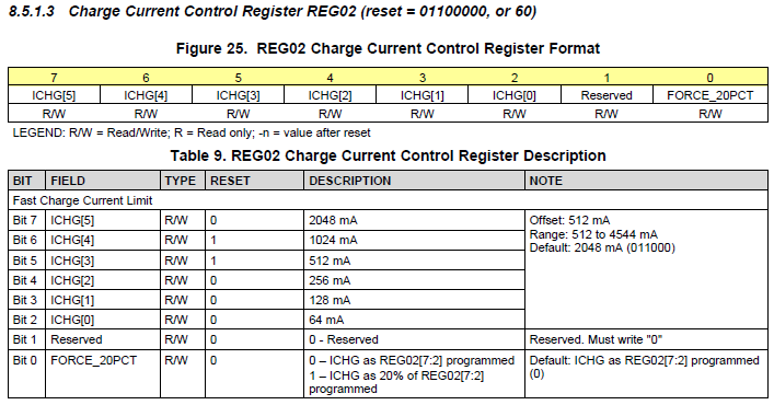

  • Hi Wyatt-san,
    It seems Chrgr_Current_Reg2() is a command that only returns the current control register of the charger (BQ24193).
    My customer doesn't access the registers of BQ24193 directly but do you refer he should access BQ24193 register directly at the begininng?
    Yaita
  • If the answer is yes, I understand he should change the following register of BQ24193.
    However, I have doubt if the value of the register relates to the issue..
    Yaita
