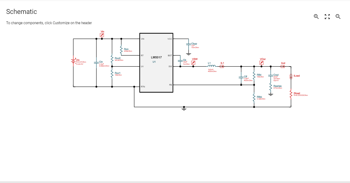

I am using  two LM5017on my board. One for 5V and the other for 24v. When before the design i used to webench.ti. By the way my input voltage is 70v DC.
The picture is recommended design by Ti.

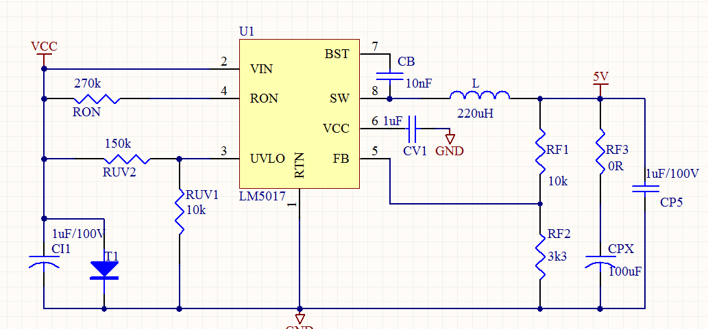

And I used this design.

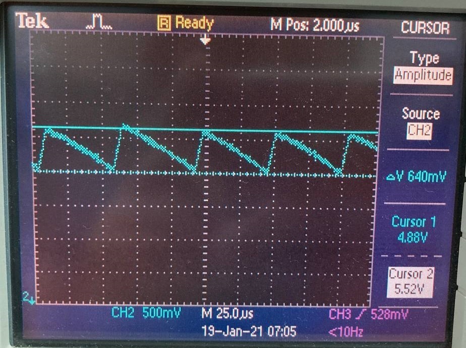

I copied this design by datasheet. And then observed 5v output i have to following graphics

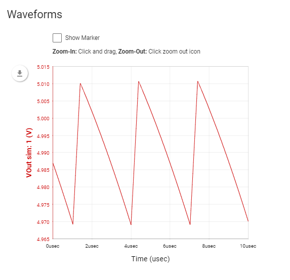

I have 640 mV ripple as can be seen in the picture. But I simulate on wibench.ti i  should have to this graphics.

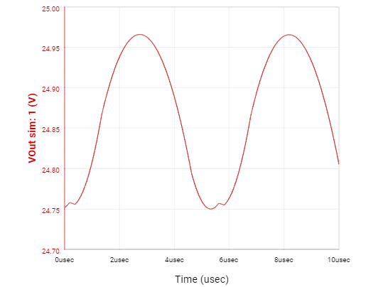

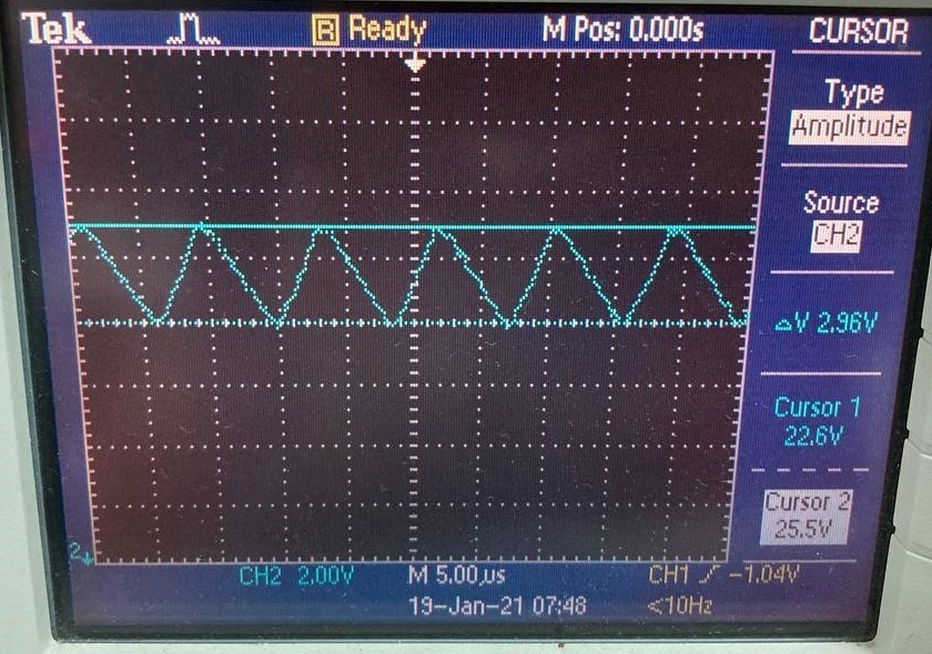

And i designed the 24V buck converter from wibench.ti and this graphs are also the graphs of the 24V line.
As can be seen in the pictures the graphs are not what hey should be. Ripples are bigger than it should be.I added capacitor and inductor to the output voltage line with values greater than the values found in the schematic. But i could not fix it.
