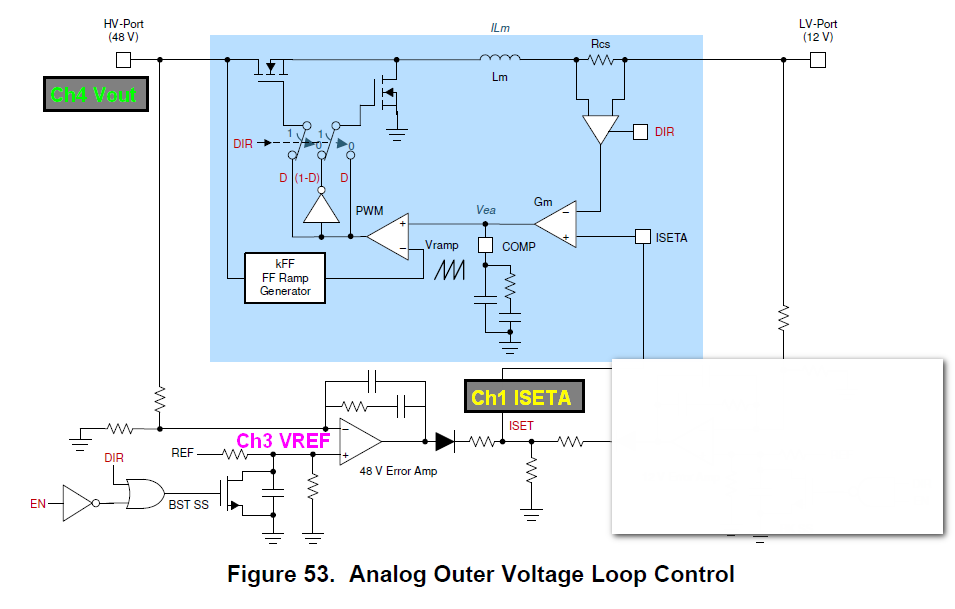

How to reduce the output voltage overshoot during LM5170 power-on?
I tried to modify the SS cap, the LM5170 comp compensation and boost mode voltage loop compensation, but no effective reduction.
I follow the LM5170 excel calculation to get the value of components (meet loop gain stable rule). While the Vout is set 48V, the max overshoot of vout is around 53.6V or higher.
Could you please provide the suggestion that reduce the overshoot?
Thanks.
Aska
  • Hi Aska,
    Thank you for the question.  You should not modify the SS capacitor.  You should increase the capacitor at the external voltage loop error amplifier's non-inverting pin, namely C92 of our standard EVM.  For the buck mode, you need to increase C90.  You should see the improvement.

  • Dear Youhao:
    Added the overshoot waveforms of Vout.
    Because the voltage of feedback divider resistor is different to Vin48 and Vin32V, we set 1.21V for 32Vin and 1.87V for 45Vin. The target level of VREF is 2.47V. So the rising time of VREF at 32Vin is around 4msec (long than 45Vin/2msec).
    Do you know why it doesn't work on 32Vin by VREF control? (It is ok at Vin48.)
    BTW, we tried to modify the Cramp but no bigger difference.
    Could you please provide some directions?
    Thank you so much.
    Aska
  • Hi Aska,
    I reviewed your waveforms but the labels confused me.  Could you clarify?
    Youhao
  • Dear Youhao:
    Sorry for confuse.
    Ch1 ISEA (pin 45 of LM5170), it comes from voltage loop.
    Ch2 EN (pin39 and pin43 of LM5170)
    Ch3 VREF, it seems C92, but it is controlled by microcontroller. We modify the rising time and level by microcontroller to achived your suggestion.
    Ch4 Vout, it is the output voltage of boost converter. It seems HV of LM5170 EVM.
    Thanks.
    Aska
  • Hi Aska,
    Thank you for the clarification.  Please understand that the actual soft-start operation is to control the duty cycle growth at a slow rate to avoid overshoot.  Since larger duty cycle is needed for lower input voltage, the soft start process would take longer time than a lower input voltage.  What I recommend is, to find a minimal Vref slew rate for your min input voltage, then always apply the same slew rate to other higher input voltages then you will always avoid getting an Vout overshoot.
    Youhao
