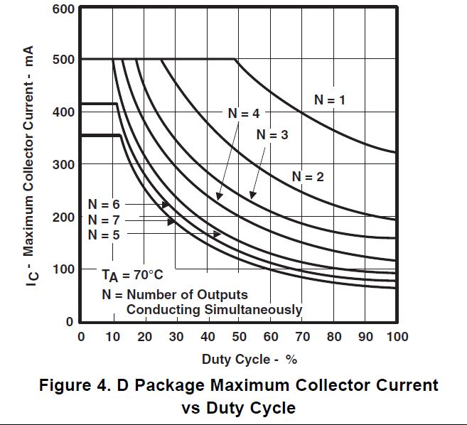

I am looking for the pulse current rating for the collector outputs. The data sheet has Figure 4 which shows the Maximum collector current based on outputs conducting and duty cycle %. However, I do not see anywhere that states what the frequency is for the duty cycle. I am trying to find how much current the collectors can take for a 20us to 200us pulse ranges.

    The peak collector current rating, even for pulses is 500mA even for short pulse.If you need higher currents, you can parallel multiple channels together.

  • Can you please explain more Figure 4 in the datasheet. What is the frequency used to make the graph. I'm trying to understand what the time frame used to produce the graph. For example, what is the 50% duty cycle time reference? 0.5 secs on and 0.5 secs off? 0.5ms on and 0.5 ms secs off? 0.5us on and 0.5 secs off? ect...

    The Figure 4 is independent of frequency and you dont need it to find out how many simultaneous channels you can run.
    When you have a high duty cycle, the darlingtons are sinking current and dissipating heat, so the more channels you have, the more heat. The higher duty cyel theyre on, the more heat. Theres a limit to the heat, thermal resistance is different for N/D packages which is why Figure 4/5 are slightly different.

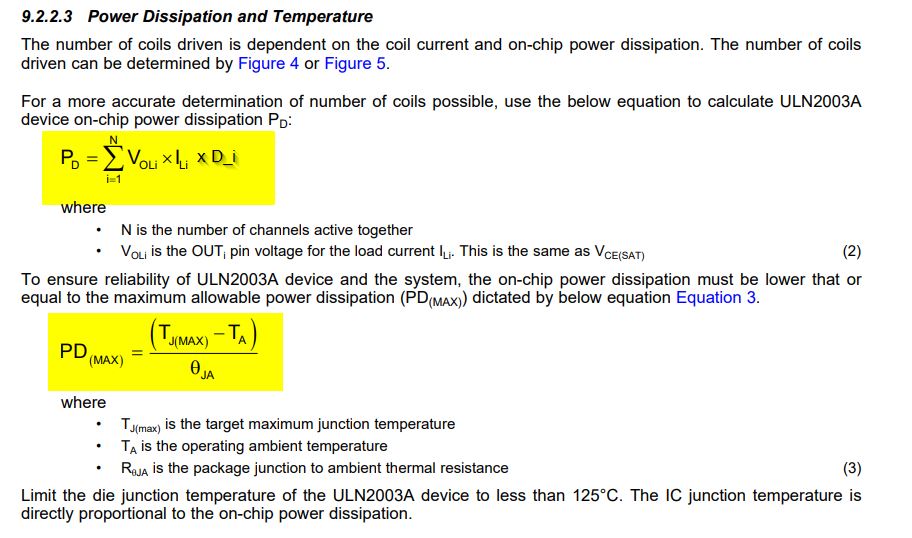

    note that figure 4/5 is at 70C ambient, and also the PEAK (the entire area below each curve is valid operating region for N=x # channels. If your ambient temperature is hotter and/or youre going to be running some channels at a certain duty cycle and others at a different duty cycle, you can apply the way the Figure 4 is generated by finding the max power you can sustain in Section 9.2.2.3, of the datasheet, excerpt below.
    I have added the "xD_i", which would be the duty cycle for the channel i..
