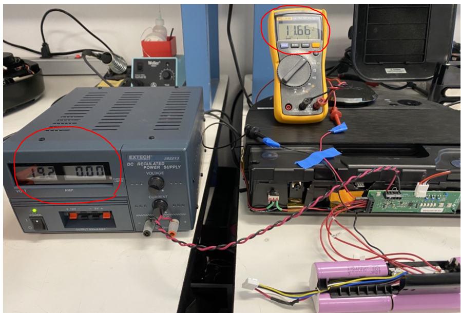

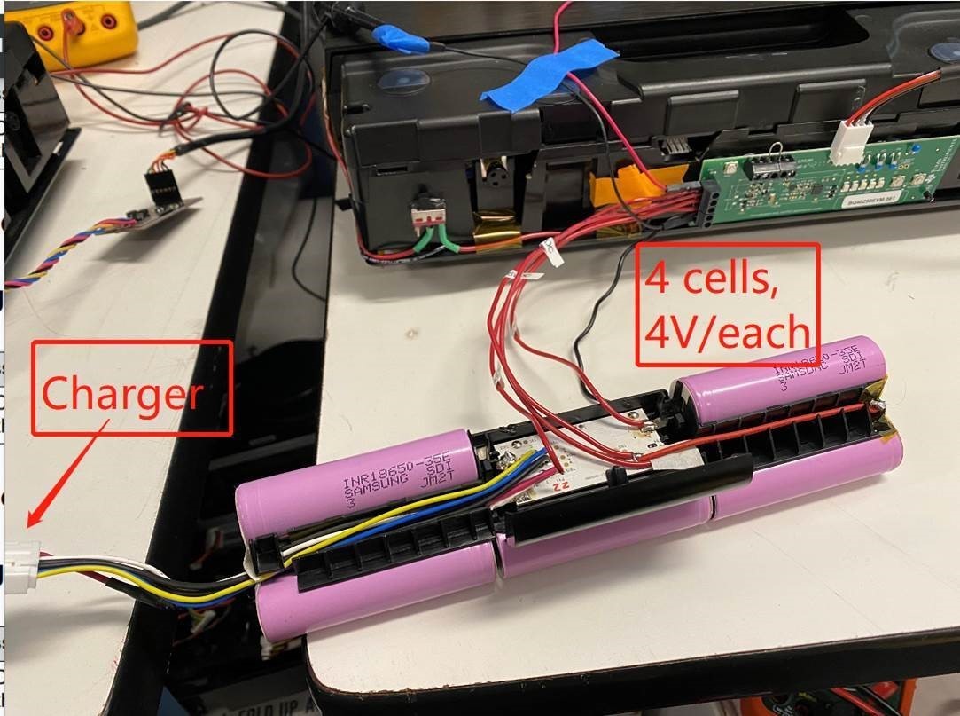

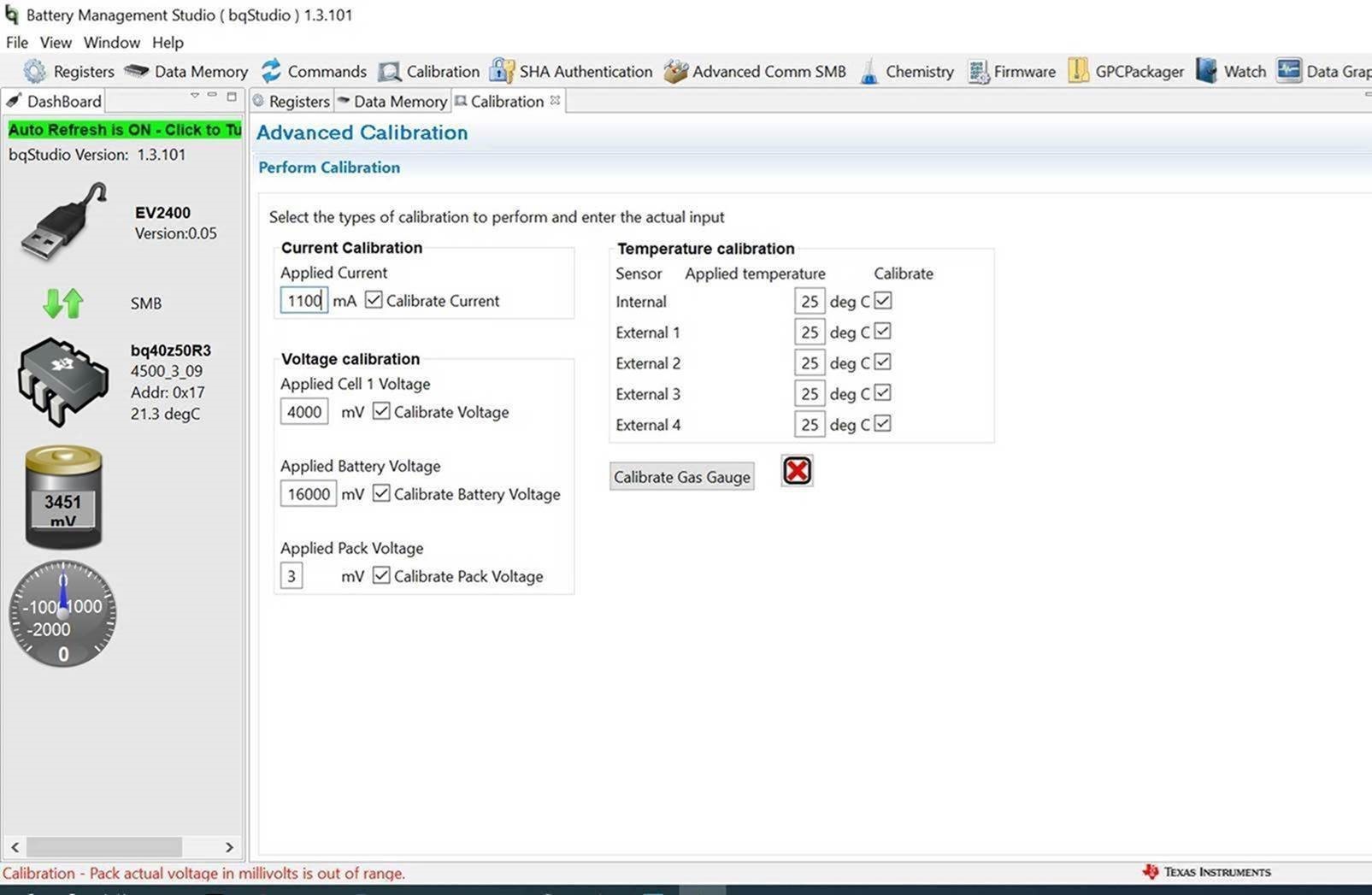

Thank you for reading my question. I am trying to do calibration for Battery Learning Cycle. However I ran into a problem when I set up Pack Voltage, 'pack voltage out of range'.
The HW Set up shows below. We use a Li-Ion battery (4 cells) for Learning Cycle.
Also I attached .gg file for your reference.
Thank you for your time.
