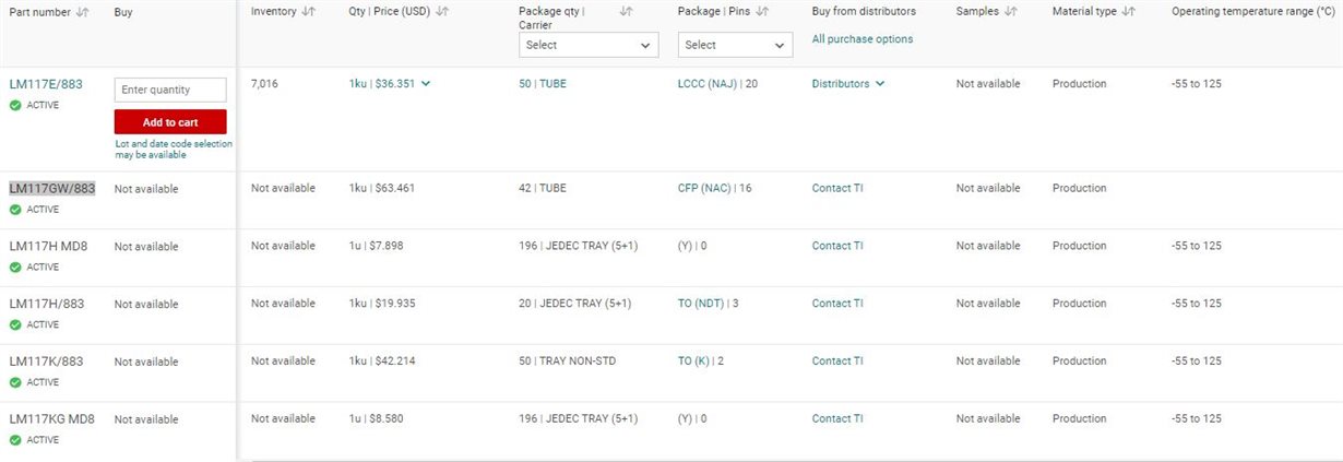

Can you confirm the operating temperature for LM117GW/883? The value is missing from the ordering table on the website and in the datasheet.
Part Number: LM117QML
Hi Gregory,
For some reason, the operating temperature is missing in the orderable table. When this happens, the datasheet number will apply which is also from -55 to 125C.
