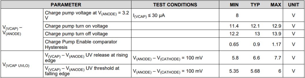

Please let us know about Revision History.
We found following description "Relaxed VCAP specs in Electrical Characteristics table" in Revision History(Rev F to Rev G).
But we couldn't find difference.
Please let us know difference about VCAP description between Rev F and Rev G.
