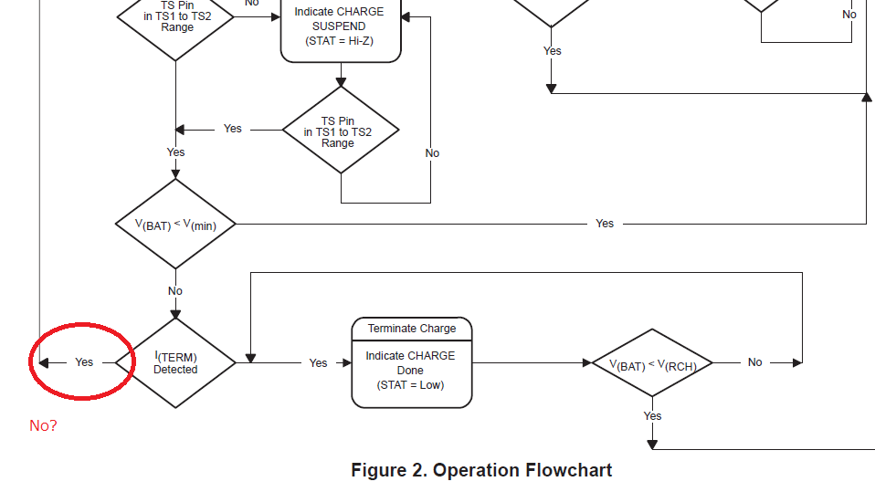

I would like to ask you about the BQ2057W device.
For the flowchart in Fig. 2 of the data sheet, is "Yes" indicated by the red circle in the attached figure correct "No"?

Hi.
Yes, the circled 'Yes' should be 'No'.
