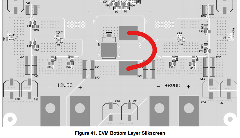

    In the pdf file you shared, there was a box of "Solder a copper strip to the two exposed pads beside D3 on the bottom side of the PCB." Is it like below so that the circuit breaker doesn't work?
    RYO

    You are right about the wire across the two pads.  You'd better to use a copper strip.
