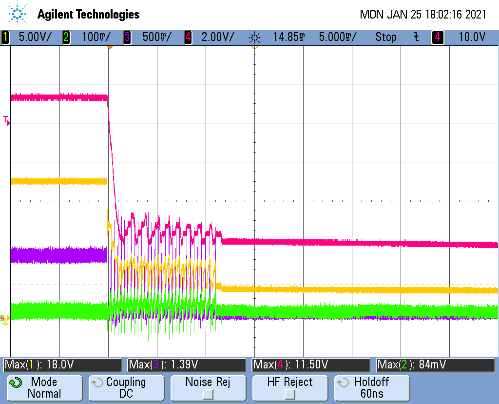

    This is the schematic (Nominal Vinput ~12V, Maximum Vinput = 20V)
    There are waveforms when shut-off occurs
    1). Yellow - Vin; Red - VOUT, Purple - Iin; Green - TIMER
    2). Yellow - GATE; Red - VOUT, Purple - Iin; Green - TIMER
    Spikes during shut-off are associated with the operation of the buck converter (12V->5V) which is connected to this bus.

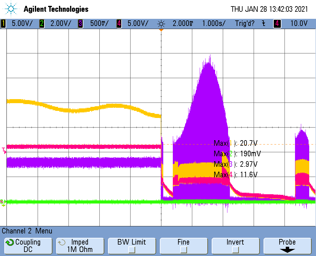

  • 10uF was added at the VIN_Fused bus, D48 was populated. Behavior of the schematic remains the same. With D24 situation is the same.
    Yellow - GATE; Red - VOUT, Purple - Iin (1V=1.5A); Green - TIMER
    In an additional experiment D23 was added. In this case schematic latched. The latching cause is overcurrent protection because Vgs voltage gets lower and IC detects an increase of Vds voltages.
  • Thanks for the waveforms.
    Is it happening even at no-load also ? As you know the overcurrent threshold of this controller changes with Ron of the MOSFET which significantly gets increased due to nearby hot-source. To verify, can you increase the current limit threshold and check.
