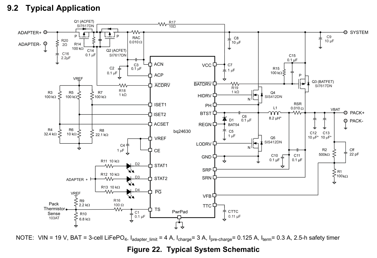

BQ24630: Can I replace MOSFET to load switch?
Part Number: BQ24630
Hello TI experts,
when I see the datasheet of BQ24630, I see typical application in figure 22, please see below;
My question is, can I replace Q1 and Q2 (connected to ADAPTER+) to load switch IC?
I think it have high voltage spec. it is not easy to replace.
If yes, can you recommend the part to replace?
Please check this issue.
