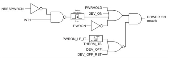

  • Kindly clarify this diagram according to your explanation in above post.
    Let PWRHOLD is tied to VRTC and device is  turned off by writing DEV_OFF to 1, Input power of PMIC is still present and as the PWRHOLD (connected to VRTC) is high, PMIC will start again.
  • Please find below the explanations of the diagram used with the state machine:
    Table1:
    Turn on request (to launch power on sequence) :
    If one of the events listed in the following table occurs AND MB>VMBCH, the power on sequence of the device is launched unless one of the gating conditions listed in Table 3 is present.
    Event Polarity
    PWRHOLD (pin) HIGH
    PWRON (pin) LOW
    NRESPWRON=0 and INT1 gets ACTIVE (a new interrupt comes while in OFF) TRUE
    For interrupt sources that can be configured as ON requests, see Table 4
    INT1 ACTIVE means :
    INT1 DEVCTRL2_REG.IT_POL
    0 0
    1 1
    Table 2:
    Keep on conditions
    If one of the conditions listed in the following table occurs before tdONPWHOLD delay,  the device will be kept on unless one of the gating conditions listed in Table 3 is present.
    Event Comment Polarity
    PWRHOLD (pin) must be set before tdONPWHOLD HIGH
    DEV_ON must be set before tdONPWHOLD 1
    PWRON= LOW AND DEVCTRL2.PWRON_LP_OFF=0
    AND DEVCTRL2.PWRON_LP_RST = 0
    must be true before tdONPWHOLD TRUE
    with t_dONPWHOLD delay to set high PWRHOLD signal or DEV_ON control bit to 1 after NRESPWRON released, to keep on the supplies (typical value: 984 ms )
    Table 3:
    Turn on and keep on gating conditions
    If one of the conditions listed in the following table occurs, it will prevent any switch on sequence and will turn OFF the device if in ACTIVE state.
    Event Maskable Polarity
    PWRON_LP_IT Yes, using INT_MSK_REG.PWRON_LP_IT_MSK
    This will mask the interrupt but not the switch off condition.
    To mask the switch off condition,  need to disable the feature by setting DEVCTRL2.PWRON_LP_OFF=0
    1
    THERM_TS Can be disabled using Therm_REG.THERM_STATE 1
    DEV_OFF (event) No 1
    DEV_OFF_RST (event) No 1
    MB <VMBLO No. This condition makes the device go in BACKUP state TRUE
    Table 4:
    Interrupts leading to Turn on request
    PWRON_IT Yes, using INT_MSK_REG.PWRON_IT_MSK
    Switch on even if interrupt masked
    HIGH
    PWRHOLD_IT Yes, using INT_MSK_REG.PWRHOLD_IT_MSK
    HIGH
    RTC_ALARM_IT Yes, using INT_MSK_REG.RTC_ALARM_IT_MSK HIGH
    RTC_TIMER_IT Yes, using INT_MSK_REG.RTC_TIMER_IT_MSK HIGH
    VMBHI_IT Yes, using INT_MSK_REG.VMBHI_IT_MSK HIGH
    Hoping it helps.
    Flore
