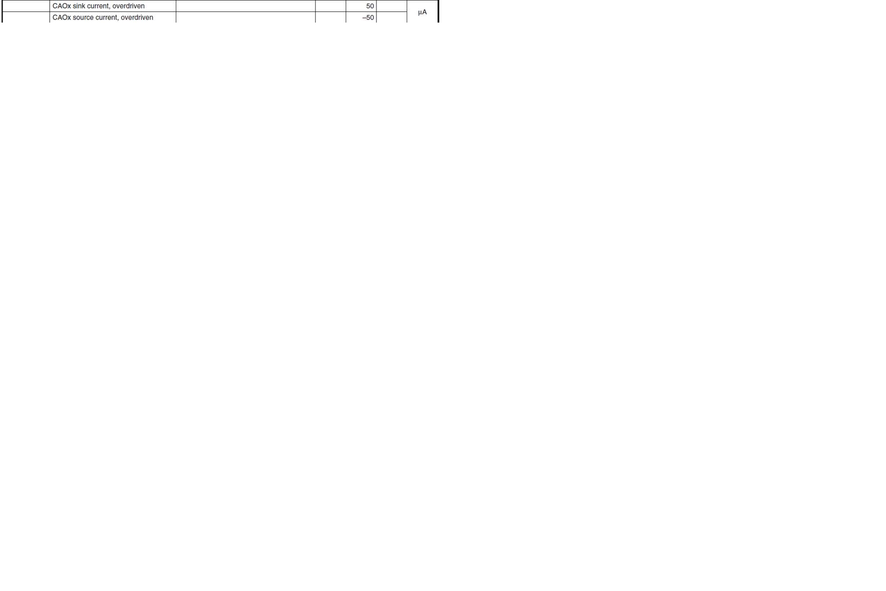

Do you have the max value of CAOx source/sink current overdriven?

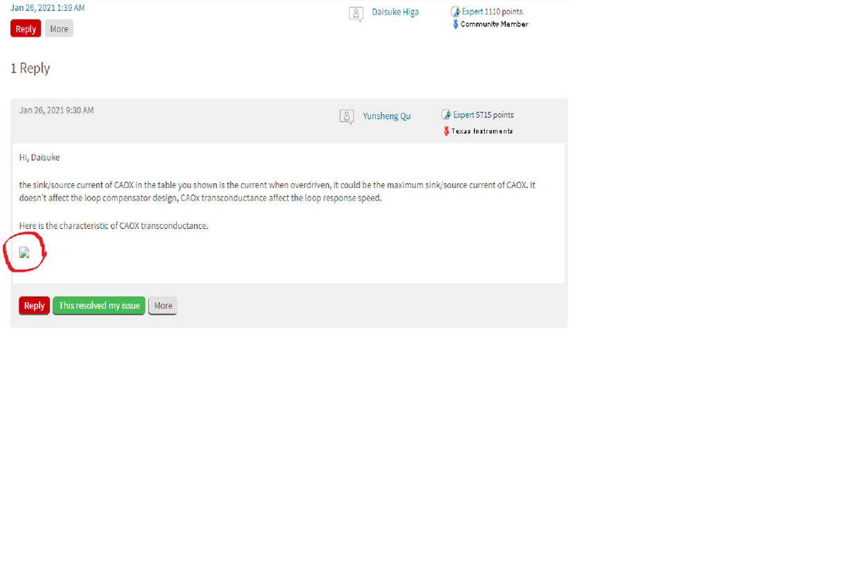

the sink/source current of CAOX in the table you shown is the current when overdriven, it could be the maximum sink/source current of CAOX. It doesn't affect the loop compensator design, CAOx transconductance affect the loop response speed.
Here is the characteristic of CAOX transconductance.
