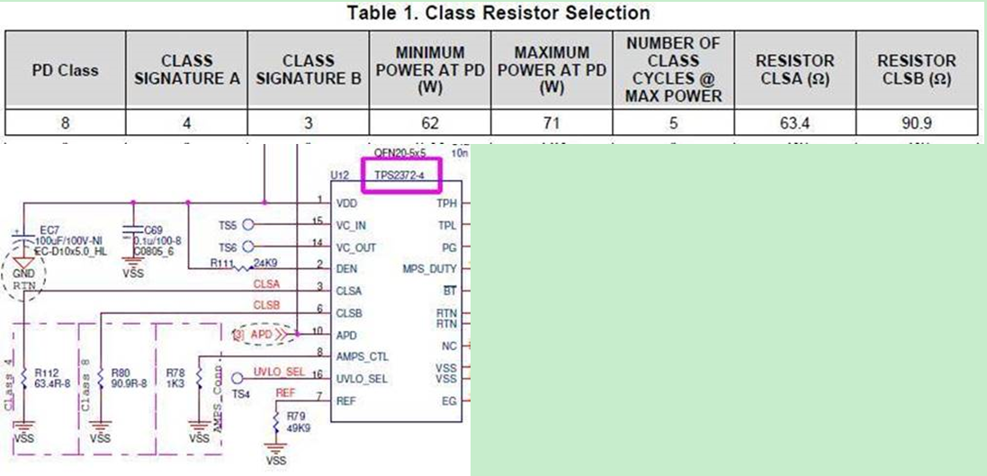

If the current class settings of TPS2372-4 are as follows, what is the difference between turning off Autoclass and turning on Autoclass when connecting to the three specifications of PSE (PoE / PoE + / PoE ++)?

    Additional question setting picture as below.

    There is no connection between the Class of the PD and the Autoclass function. The class of the PD sets what the power level the PD requests from the PSE. Autoclass is part of the IEEE802.3.bt standard which states that if both PSE and PD support Autoclass, then for a specific interval after startup, the PD must draw its maximum power level, and the PSE will make that power draw the maximum power instead of the Class power level. For example, if a PD drew 68W in the interval, that would be the new maximum power the PSE would allocate to the PD, instead of 71W.
    I do not recommend using it.

  • Dear Michael,
    Do you mean that automatic classification function is not recommended?
    Thanks & Best Regards,
    Tom Chang
  • Yes.
