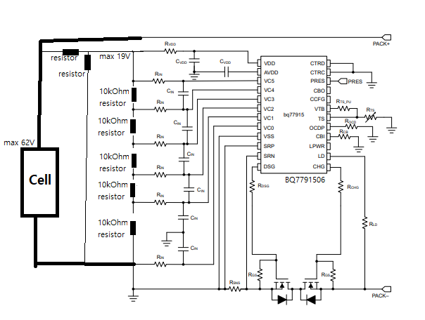

  • Hi Xiaodong,
    OC is mandatory so I would like to suggest below circuit.
    Could you review it?
    They don't need cell balancing so there is 10kOhm resistor instead of cells. it's similar to simulation mode with power supply.
    Additional 2 resistors are for voltage dividing from max 62V to max 19V(3.8V OV protection)
    If you have the concern, please let me know.
    Thanks.
  • Hi David,
    If the customer is ok with the leakage from the divider, I think this solution would work. Thanks.
