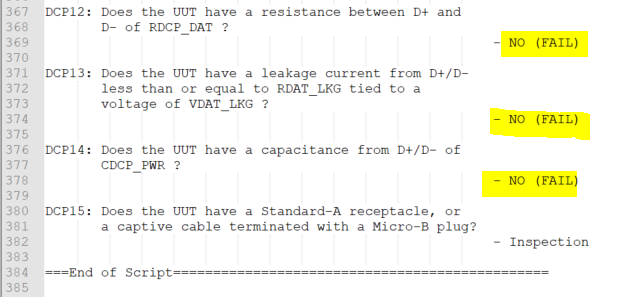

My customer has one docking project that faced BC1.2 compliance failure.
May I get your help to review these failure and provide some advice?
Thank you.

Hi Jim,
I am unable to open the file type you have sent. Can you tell me what failed and what mode you were in?
Emma
Hi Jim,
Was it BC1.2 DCP or was it DCP auto? What were the CTL/ILIM_SEL pin settings during testing?
DCP_auto is not a BC1.2 compliant mode, which is why I ask.
Emma
Hi Emma,
Thanks for the information.
So if the customer would like to pass BC1.2 DCP test, they should use pure DCP mode(DCP_Shorted) in the datasheet, am I correct?
