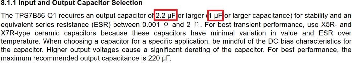

I have a question regarding the output capacitor. There is the following paragraph in the datasheet. My understanding is as following:
  1. 2.2µF is the recommended nominal value of the MLCC;
  2. 1µF is the minimum real capacitance which considers the DC bias, temperature co-efficiency, aging, tolerance and so on.
Is my above understanding correct?
