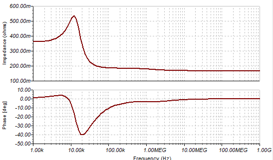

I am simulating output impedance of the TPS54160 power supply, and I am seeing results which do not match what I would expect.
I would expect the output impedance to start high, dip in the center, and rise again at higher frequencies.
The simulation I am using is also included. What am I doing wrong?
TPS54160_Simulation.TSC

  • Jacob,
    The output impedance of the simulation seems to be okay.
    The output impedance will start off low because the loop gain is high at low frequencies. As the frequency increases the loop gain will drop and output impedance will increase. Eventually, there will be some peaking due to the loop dynamics.
    And at frequencies above the loop bandwidth, the loop gain is less than one, so it can't help but reduce the output impedance.
