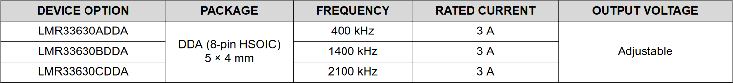

Thanks for your interest in using a TI device. I do not have a pin-to-pin solution for this case, but the LMR33630 has the same functionality.

Can you suggest some easy options for hand solder like SOIC? simple option compare to QFN?
LMR33630ADDAR is perfectly suited for our application for 5V 3A.

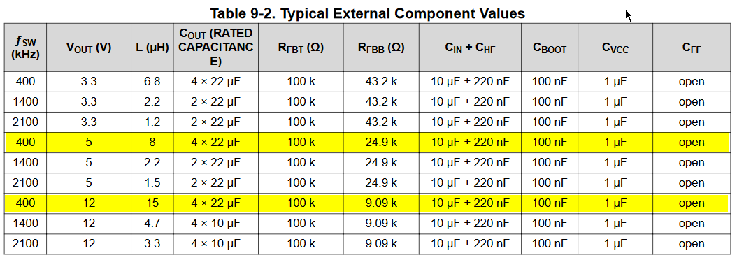

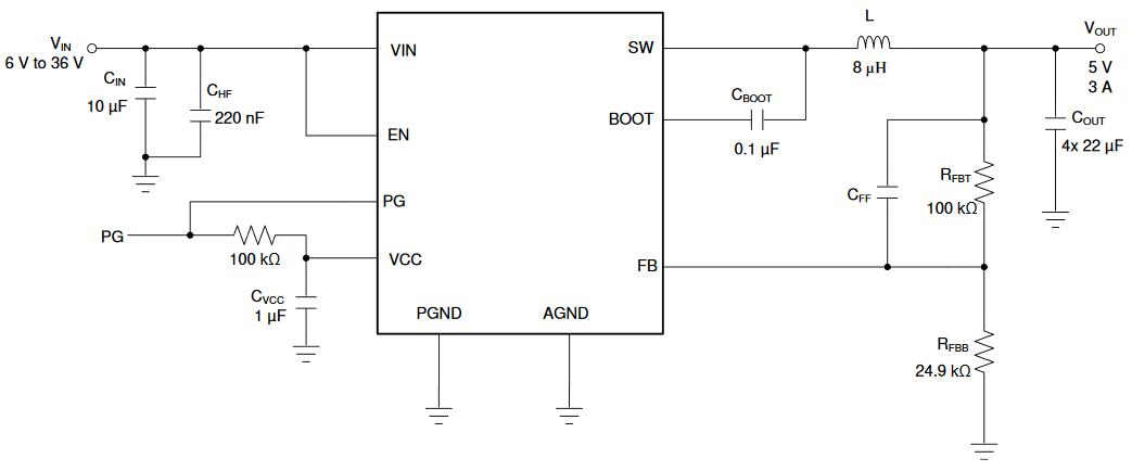

Please provide an application schematic with Inductor and Capacitor values for 12V 3A Using LMR33630ADDAR 400kHz.

Murthy,
Please take a look at the Typical Application Section in the datasheet which provides the typical components for your specific conditions in which you are requesting.

Yes 5V I know, I asked for 12 V DC output.

Murthy,
The typical application section provides the following info:
Also, I recommend using our WEBENCH tool which creates customized power supply circuits based on your requirements. The WEBENCH tool for this device can be found at the bottom of the product folder under Design & Development.
