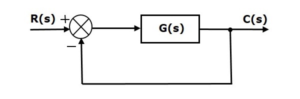

    Thank you for your reply. Our customer has the following additional questions:
    1. Do the modulator and feedback transfer functions are given in the datasheet correspond to G(s) and H(s) in the attached screenshot? If so, what do the inputs and outputs R(s) and C(s) represent? If not, would you be able to provide a block diagram to make it more clear?
    2. We followed the recommendations for loop compensation components in 8.2.2.19 and we got a system with about 1 degree of phase margin and 1 dB of gain margin. Is that a reasonable result? If so, what approach would you recommend for increasing the gain and phase margins of the system?

  • Hi Carlo,
    1. Sorry for the confusion. That is essentially correct. The input R(s) represents the perturbation source which we would like to investigate. It is usually input voltage or output current. The output C(s) is the output voltage.
    2. That is not good. We usually need >45 deg phase margin and >10dB gain margin at least. Do you know what are their Rcomp, Ccomp, and Chf values?
